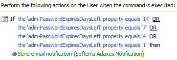

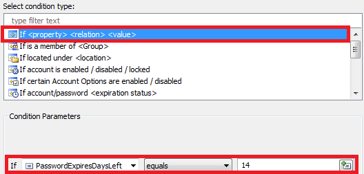

There is no need to use PowerShell script. You can achieve what you need using built-in conditions. Also, you need only one Scheduled Task with only one set of actions and conditions. To create such a task:
  3. On step 3 of the Create Scheduled Task wizard, select User object type and click Next.
  4. Click Add Action and select Send e-mail notification.
  5. Fill in the fields and click OK.

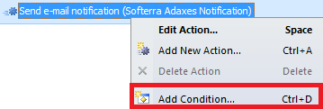

  6. Right-click the action you have created and click Add Condition.
  7. Select If .
  8. Select If PasswordExpiresDaysLeft equals 14 and click OK.
  9. Repeat steps 6-8 for each condition you need (7, 3 and 1 day).
  10. Click the AND logical operator to change it to OR.
  11. Finish creating the Scheduled Task.
You should have something like the following:
by (220 points)

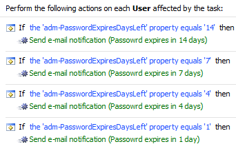

If I maintain my 4 separate actions, and switch the condition to PasswordExpiresDaysLeft, can I achieve my result intended result, or will I still have overlap?
I also have a task that sends an SMS "if password has expired". The intention is for this SMS to be sent only one time, but I now see it's sending it every day when the task runs. Is there a condition I can use that will cause this to only be sent once?
Yes. That is exactly what you need. The Task will look like the following:

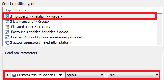

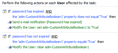

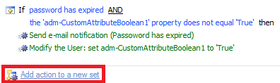

You need to add a condition that will check whether a notification has already been sent. For this purpose, you can use a certain flag. When sending the notification, you can set the flag to prevent further notifications. When a user changes or resets a password, the flag needs to be removed.
To achieve this, we recommend using a Boolean Adaxes Custom Attribute (e.g. CustomAttributeBoolean1). Adaxes custom attributes are virtual properties that are not stored in Active Directory, but can be used as any other property of directory objects. To set the flag, you can set the attribute to True, and to remove it, you can clear the attribute. In other words, your task will look something like the following:
To add the required actions and conditions to your Scheduled Task:

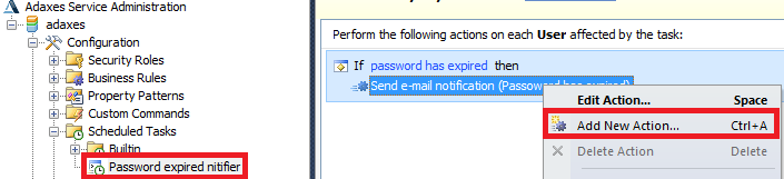

  2. Navigate to Configuration/Scheduled Tasks and select the task.
  3. Right-click the Send e-mail notification action and click Add New Action in the context menu.

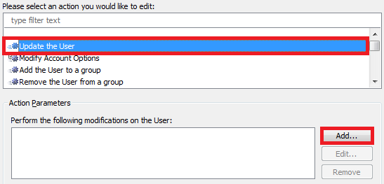

  4. Select Update the User and click Add.
  5. Select CustomAttributeBoolean1 in the Property to modify drop-down list.
  6. Select True in the New value field and click OK.

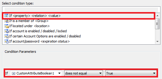

  7. Right-click the Send e-mail notification action again and click Add Condition in the context menu.
  8. Select If .
  9. Select If CustomAttributeBoolean1 does not equal True and click OK.

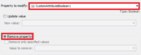

  10. Click Add action to a new set in the Result Pane.
  11. Select Update the User and click Add.
  12. Select CustomAttributeBoolean1 in the Property to modify drop-down list.
  13. Select Remove property and click OK twice.

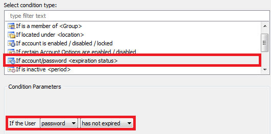

  14. Double-click Always and select If account/password .
  15. Select If the User password has not expired and click OK.

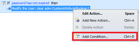

  16. Right-click the action you have created and click Add Condition in the context menu.
  17. Select If .
  18. Select If CustomAttributeBoolean1 equals True.
  19. Click OK and save the changes.
