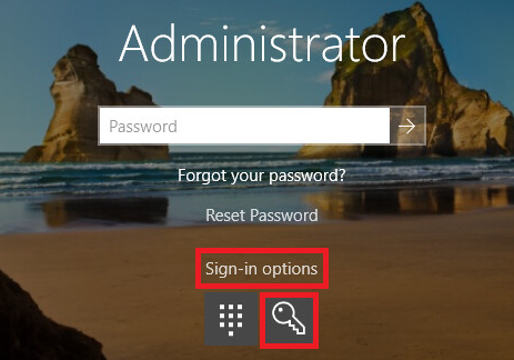

Adaxes Self-Service Client installs an additional Logon Provider on a user's computer. Then it is up to Windows to select which providers to display, and which of them will be available by default. When you install the Duo client, does Adaxes Self-Service Client disappear completely from the Logon Screen or you can access it via Sign-In Options? If it is present, try selecting the client and see if it sticks as the default one.
If Adaxes client disappears completely, most probably, the Duo client disables it, for example, using a method described in this Technet Library Article or similar to it. Try checking the Logon Provider-related registry keys mentioned in the article or contact Duo Support for further assistance.

Both the Logon Providers can coexist together on the same computer, however we don't see any possibility to use both at the same time. So, users will need to click the Sign-in options link and select either the Duo provider or Adaxes Self-Service Client.
