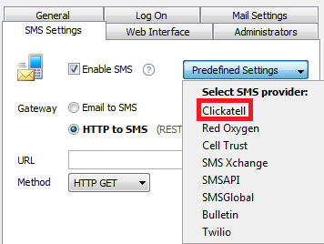

Im trying to properly set HTTP to SMS (Rest API) Header for Clickatel.
Specifically for 2-way SMS needed for sending to US mobile numbers.
any suggestion how to do it?
thank you
DoD
by (50 points)
For information on how to configure SMS settings, have a look at the following help article: https://www.adaxes.com/help/?HowDoI.Man ... tings.html. Clickatell is present in the list of Predefined Settings, you only need to enter your API key and the settings will be applied automatically.
If there are additional settings required in your case, contact Clickatell support for details and then apply the settings in Adaxes Administration Console.
by (50 points)
Thank you for reply.
I already did so. Its working fine.
But for 2-way SMS (different API key) I got reply "US Number limitation" when try to test it.
There must be some difference in header format.
regards
DoD
Unfortunately, we did not find any details regarding this point in Clickatell documentation. Probably you are right and there is a difference in header format. We recommend you to contact Clickatell support for required settings. Should you find a solution, please update this topic.
