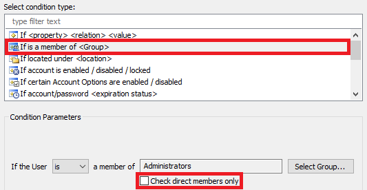

We are wanting to specify a group in the code, and have it check that group plus all nested groups.
That is exactly what the second script from the repository article does. You need to specify the distinguished name (DN) of the group in the $groupDNs variable. The script will return true if the user is a member of the group itself or any of its nested groups.
If you need to check membership of only one group, you can use the built-in condition If is a member of . To check membership in nested groups, make sure the Check direct members only option is not enabled.
