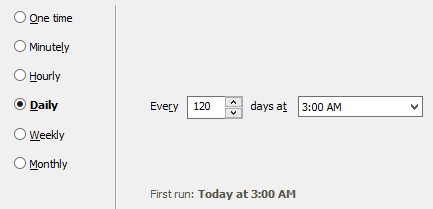

Is it possible to schedule quarterly or yearly (eg. twice a year) for reports in version 2018.1 ?
Seems that monthly is as far as it can be streched?
by (500 points)
No, there is no such possibility.
Yes, that is correct.
by (500 points)
Thanks for the info!
Could be nice to have that option in future updates to the product - where do I put in a request for that feature?
We have already added the feature to the list for future updates. Thank you for the suggestion.
Also, you can currently schedule for a specific number of days (e.g. 120).
by (500 points)
