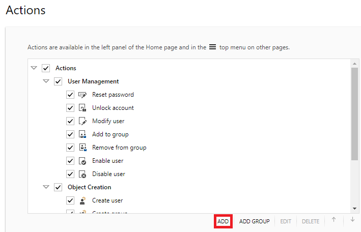

i. Creating the Action
  3. In the Actions section, click Add.
  4. Select Modify User and click Next three times.

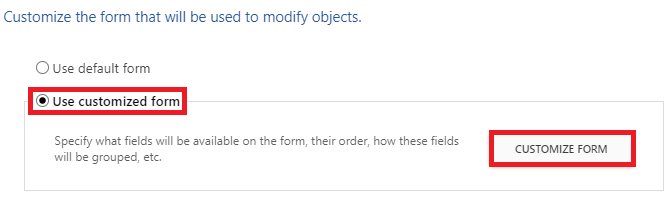

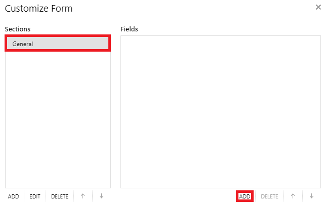

  5. Select Use customized form and click Customize form.
  6. Remove all the sections except for one (e.g. General).

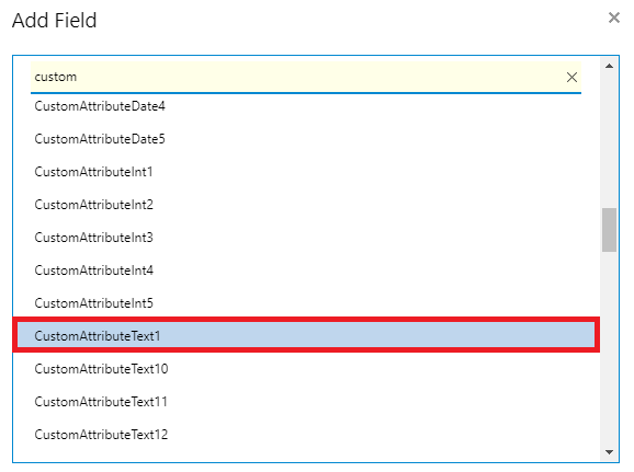

  7. Remove all the properties from the Fields section and click Add below.
  8. Select CustomAttributeText1 and click OK.
  9. Below the Fields section, click Add .
  10. Select CustomAttributeText2 and click OK.
  11. Below the Fields section, click Add again.
  12. Select Assistant and click OK.

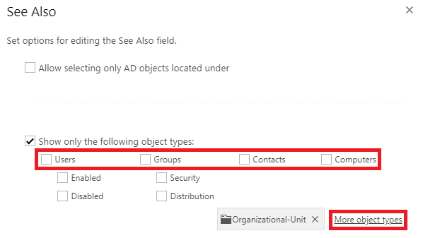

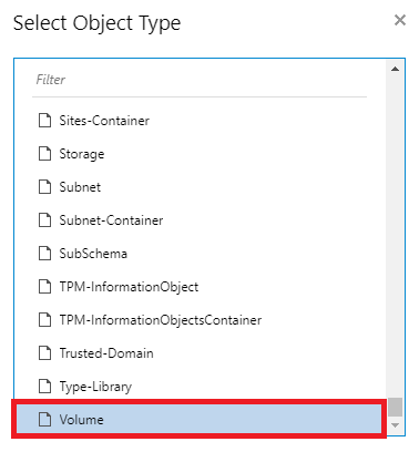

  13. In the dialog box that opens, clear the checkboxes for all Object types and click More object types.
  14. Select the Volume Object type and click OK three times.
  15. Click Finish.

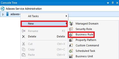

ii. Creating the Business Rule

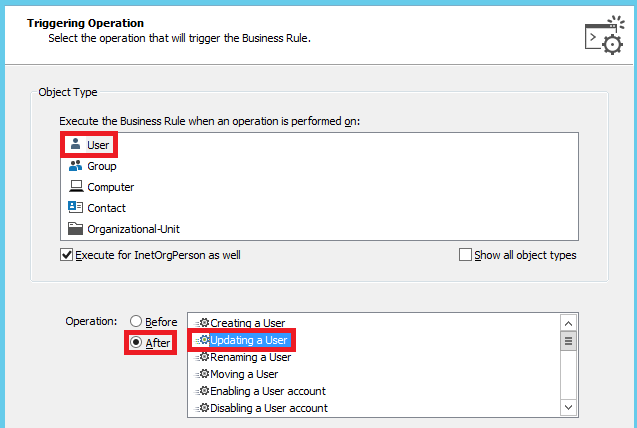

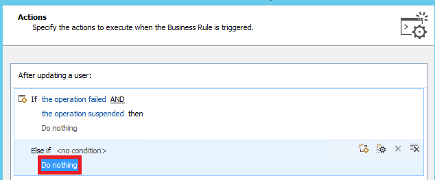

  4. On step 2 of the Create Business Rule wizard, select User Object type.
  5. Select After Updating a User and click Next.
  6. Click Add an action and click OK (do not select any action).
  7. Double-click the operation succeeded.
  8. Select failed and click OK.

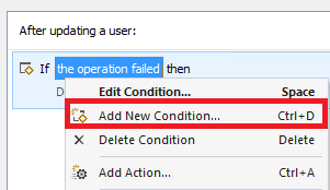

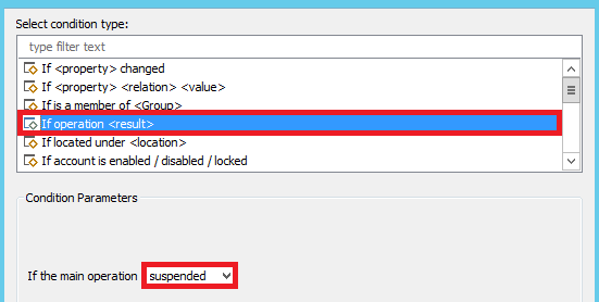

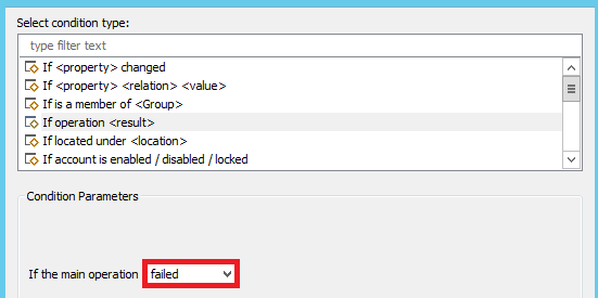

  9. Right-click the updated condition and click Add New Condition in the context menu.
  10. Select If operation .
  11. Select suspended and click OK.

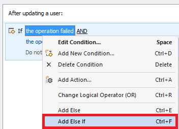

  12. Click the AND logical operator (it will change to OR).
  13. Right-click the operation failed and click Add Else If in the context menu.
  14. Double-click Do nothing in the Else if block.

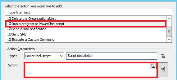

  15. Select Run a program or PowerShell script.
  16. Paste the below script into the Script field.

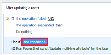

  18. Double-click no condition in the Else if block.

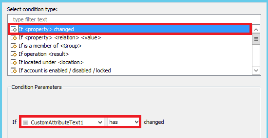

  19. Select If changed.
  20. Select If CustomAttributeText1 has changed and click OK.
  21. Right-click the condition you created and click Add New Condition in the context menu.
  22. Select If changed.
  23. Select If CustomAttributeText2 has changed and click OK.
  24. Repeat steps 21-23 for the Assistant property.
  25. Click the AND logical operator (it will change to OR).

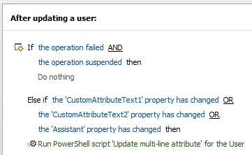

  26. Click Next and finish creating the Business Rule. You should have something like the following:
