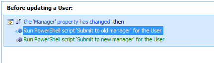

I have a business rule for manager changes which sends to the current manager for authorisation.
I would like it to skip this authorisation if the current manager is blank.
Can you help please?
The step currently looks like this:
$Context.SubmitForApproval(@($null), $True, $False, $False, $False)
by (840 points)
Could you post here or send us (support[at]adaxes.com) in TXT format the Submit to old manager script?
by (840 points)
Here it is :D
$newValue = $Context.GetModifiedPropertyValue("manager")
$Context.SubmitForApproval(@($newValue), $False, $False, $False, $False)
Thanks.
Actually, your script gets the new manager that was set for a user, not the old one. For details check the GetModifiedPropertyValue method description in our SDK: https://www.adaxes.com/sdk/?ExecuteScri ... Class.html. To achieve what you need, use the below script:
    $manager = $Context.TargetObject.Get("manager")
$Context.SubmitForApproval($manager, $False, $False, $False, $False)
