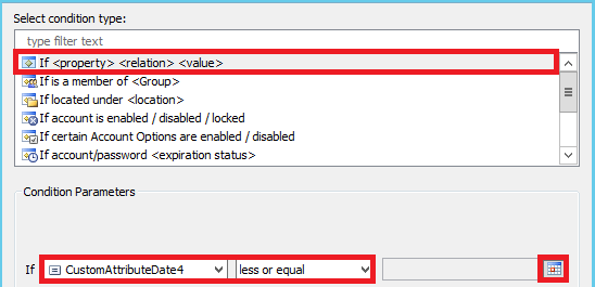

  9. Select If .
  10. Select If CustomAttributeDate4 less or equal and click Edit.

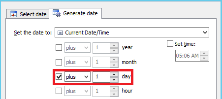

  11. Select plus 1 day and click OK twice.

  13. Select If .
  14. Select If CustomAttributeDate4 greater or equal and click Edit.

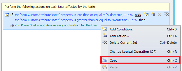

  16. Right-click the set of actions and conditions you have created (not a separate action or condition) and click Copy.
  17. Press Ctrl+V.

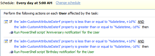

  20. Click Next and finish creating the Scheduled Task.Finally, you will have something like the following:

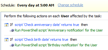

I just tested it and didn't seam to work. I'm not sure how it will when the date is as follows. 11/5/1982. Is there another field type I should be using that doesn't have they birth year?
You will need to use the If PowerShell script returns true condition instead of two If conditions in each set of actions and conditions. Finally, your Scheduled Task will look like the following:
In the condition, use the below script. In the script, the $attributeName variable specifies LDAP name of the custom attribute storing the birth date or the anniversary date (i.e. adm-CustomAttributeDate4 and adm-CustomAttributeDate5 in your case).
