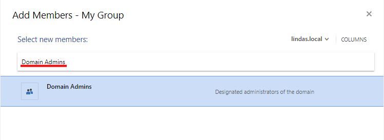

How do I get domain-admins?
Which permission do I need to configure to appear in the group?
https://imgur.com/4Wy6rOb
by (360 points)
If you want to add the Domain Admins group to the Teste V2 group, try the Domain Admins filter in the Add Members dialog.
If the Domain Admins group is not displayed in the list, you do not have permissions to view the group. For information on how to delegate permissions to view Active Directory objects, have a look at the following tutorial: https://www.adaxes.com/tutorials_Delega ... mUsers.htm.
If this is not what you need, clarify what exactly you try to achieve so we could assist you.
