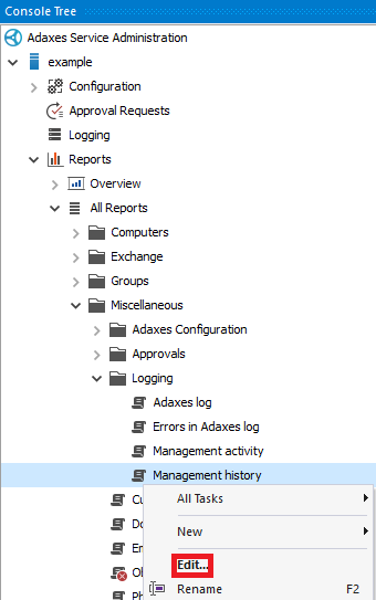

  3. Navigate to Reports\All Reports\Micsellaneous\Logging.
  4. Right-click the Management History report and then click Edit in the context menu.

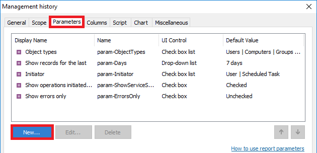

  5. Activate the Parameters tab and click New.
  6. Select Property name picker and click Next.
  7. Enter a parameter name and display name (e.g. PropertyName and Property Name).
  8. Click Next and then click Finish.

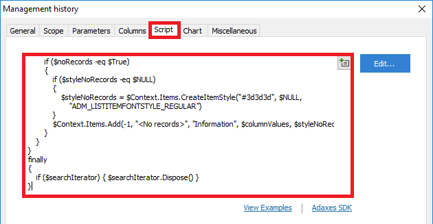

  9. Activate the Script tab.
  10. Paste the below script into the corresponding field. In the script:

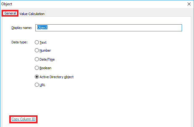

    • The $objectColumnID variable specifies the identifier of the Object custom column. To get the identifier:

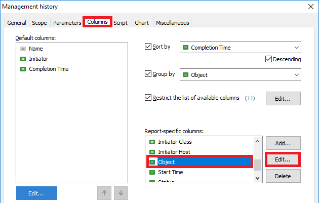

      1. Activate the Columns tab.
      2. In the Report-specific columns section, select the Object column and click Edit.
      3. On the General tab, click Copy Column ID.
      4. The column identifier will be copied to clipboard.
     # Get parameter values
     $ldapPropertyName = $Context.GetParameterValue("param-PropertyName")
     $objectTypes = $Context.GetParameterValue("param-ObjectTypes")
     $days = $Context.GetParameterValue("param-Days")
     $initiator = $Context.GetParameterValue("param-Initiator")
     $showServiceSender = $Context.GetParameterValue("param-ShowServiceSender") -eq "1"
     $errorsOnly = $Context.GetParameterValue("param-ErrorsOnly") -eq "1"
     $initiatorUser = $initiator.IndexOf("1") -ge 0
     $initiatorScheduledTask = $initiator.IndexOf("2") -ge 0
     $anyInitiator = $initiatorUser -and $initiatorScheduledTask
     $startDate = (Get-Date).AddDays(- $days)
     $endDate = Get-Date
     # Search filter
     $filterObjectTypes = "(|" + $objectTypes + ")"
     $Context.DirectorySearcher.AppendFilter($filterObjectTypes)
     # Custom column identifiers
     $objectColumnID = "{5c1618e5-af1a-482e-bc5e-7032e1eecba3}"
     # Add properties necessary to generate the report
     $Context.DirectorySearcher.SearchParameters.PropertiesToLoad.Add("distinguishedName")
     # Get display name for the selected property
     $path = $Context.GetWellKnownContainerPath("ConfigurationSetSettings")
     $configurationContainer = $Context.BindToObject($path)
     $culture = [System.Globalization.CultureInfo]::CurrentCulture
     $attributeFriendlyNames = $configurationContainer.GetAttributeFriendlyNames($culture.ThreeLetterISOLanguageName, "ADM_GETATTRFRIENDLYNAMESMODE_MERGED")
     $propertyFriendlyNameByTypes = @{}
     foreach ($attributeFriendlyName in $attributeFriendlyNames)
         if ($attributeFriendlyName.AttributeName -ne $ldapPropertyName)
         $propertyFriendlyNameByTypes.Add("Default", $attributeFriendlyName.GenericFriendlyName)
         foreach ($type in $attributeFriendlyName.TypeSpecificFriendlyNames)
             $propertyFriendlyNameByTypes.Add($type.ObjectType, $type.FriendlyName)
         break
     # Generate report
             $dn = $searchResult.GetPropertyByName("distinguishedName").Values[0]
             $columnValues = @{ $objectColumnID = $dn }
             # Get Modification Log for the object
             $obj = $Context.BindToObjectBySearchResult($searchResult)
             $modificationLog = $obj.GetModificationLog()
             $modificationLog.StartDateTime = $startDate
             $modificationLog.EndDateTime = $endDate
             $log = $modificationLog.Log
             $records = $log.GetPage(0)
             # Add log records to the report
             $noRecords = $True
             foreach ($record in $records)
                 if ($Context.Items.Aborted)
                 if ($errorsOnly -and -not(
                     ($record.State -eq "OPERATION_STATE_FAILED_CAN_CONTINUE") -or
                     ($record.State -eq "OPERATION_STATE_FAILED_NO_CONTINUE")))
                 if (-not $anyInitiator)
                     $initiatorClass = $record.Initiator.ObjectClass
                     if ((($initiatorUser -eq $False) -and $initiatorClass -ieq "user") -or
                         (($initiatorScheduledTask -eq $False) -and
                             (($initiatorClass -ieq "adm-ScheduledTask") -or
                             ($initiatorClass -ieq "adm-ReportScheduledTask"))))
                 if (-not $showServiceSender)
                     if ($record.CommandSender -ieq "Service")
                 if ($propertyFriendlyNameByTypes.ContainsKey($record.TargetObjectType))
                     $propertyFriendlyName = $propertyFriendlyNameByTypes[$record.TargetObjectType]
                     $propertyFriendlyName = $propertyFriendlyNameByTypes["Default"]
                 if ($record.DescriptionXml -notmatch "<propertyName>$propertyFriendlyName</propertyName>")
                 $Context.Items.Add($record, $columnValues, $NULL)
                 $noRecords = $False
             # If there are no records, add <No records> item
             if ($noRecords -eq $True)
                 if ($styleNoRecords -eq $NULL)
                     $styleNoRecords = $Context.Items.CreateItemStyle("#3d3d3d", $NULL,
                         "ADM_LISTITEMFONTSTYLE_REGULAR")
                 $Context.Items.Add(-1, "<No records>", "Information", $columnValues, $styleNoRecords)
  11. Click OK.
