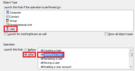

  4. On step 2 of the Create Business Rule wizard, select User object type.
  5. Select After Updating a User and click Next.

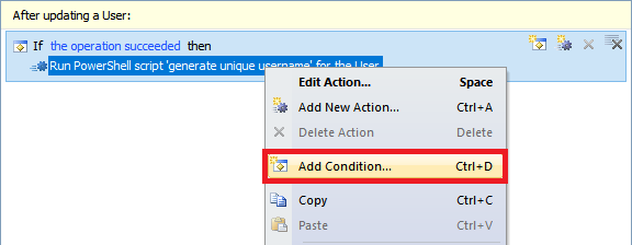

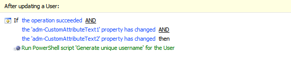

  11. Right-click the action you created and then click Add Condition.

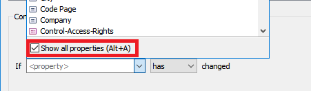

  12. Select If changed.
  13. Expand the dropdown list and select the Show all properties checkbox.
  14. Select the property used to specify the first name (e.g. CustomAttributeText1).
  15. Click OK.
  16. Repeat steps 11-15 for the custom attribute used to specify the last name.
  17. Click Next and finish creating the Business Rule. Finally, it should look like this:

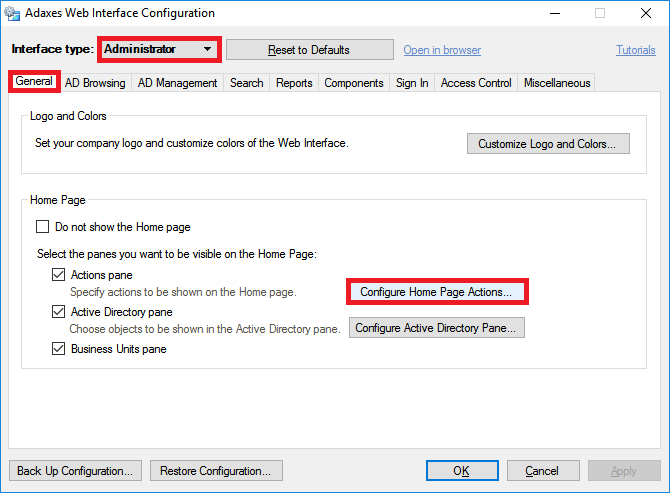

ii. Creating the Web Interface action
  2. Select the Web Interface you need.
  4. Click Add.

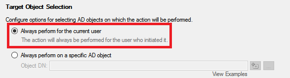

  6. On step 3 of the Add Home Page Action wizard, select Always perform for the current user and click Next.

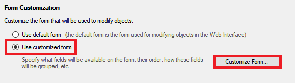

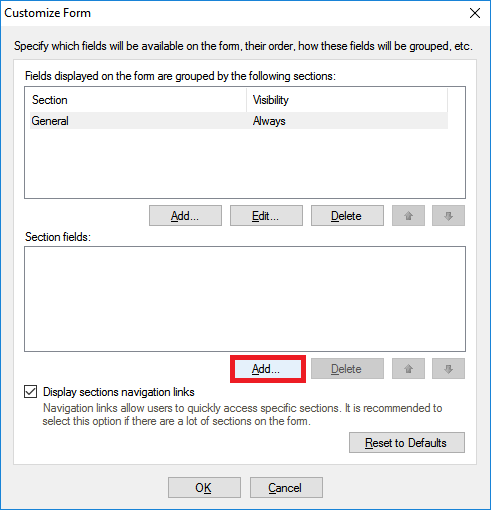

  7. Select Use customized form and click Customize Form.
  8. Delete all sections except for one (e.g. General).
  9. Delete all properties from the remaining section.

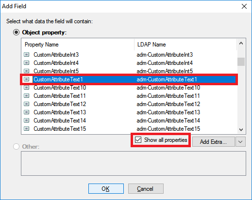

  10. Below Section fields, click Add.
  11. Select the Show all properties checkbox and select the property specified in the Business Rule condition.
  12. Click OK.
  13. Repeat steps 10-12 to add the second property.
