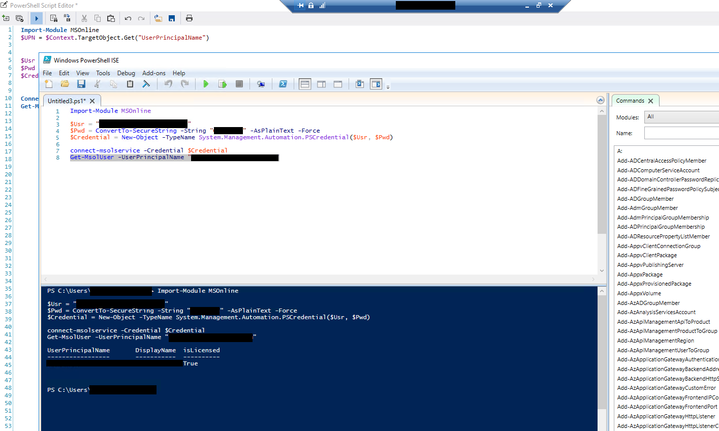

can you please advise how to properly troubleshoot Connect-MSOlService? I have x64 Adaxes installation

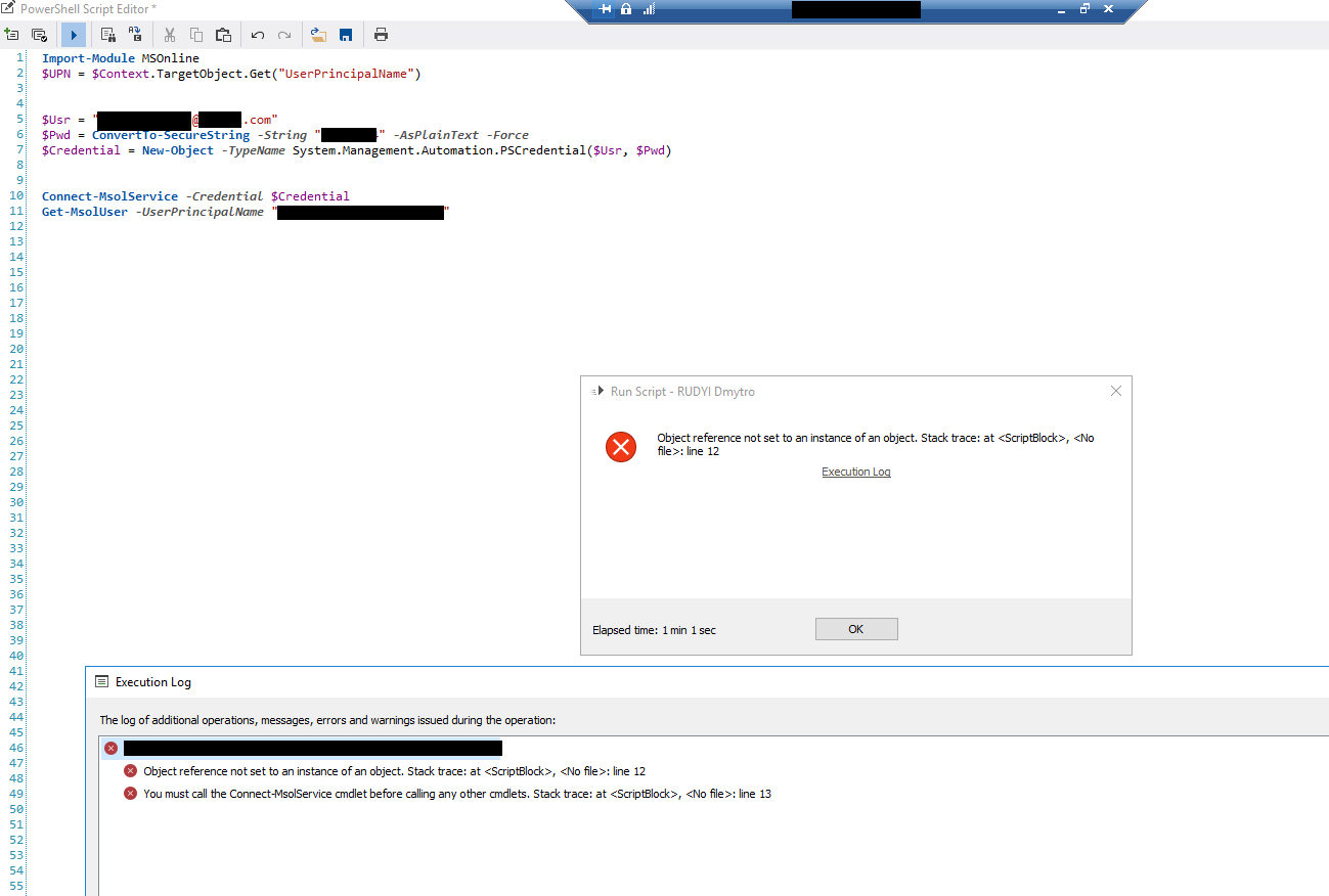

I have this function properly working in Powershell ISE and Powershell console on the Adaxes server, but when I try to run it in PS script inside Adaxes - I get a 1 minute wait and then "Object reference not set to an instance of an object".
I have Microsoft Online Services Sign-In Assistant install from https://www.microsoft.com/en-us/downloa ... x?id=28177
I have MSOnline module installed via Powershell.
Version Name Repository Description
1.1.183.17 MSOnline PSGallery Microsoft Azure Active Directory Module for Wind...
Powershell version 5.1
Thanks for any advise!

after changing config file - the log doesn't appear while running this code. So it doesn't even send the request, I guess
No, this tenant is not registered in Adaxes, but it works fine :)

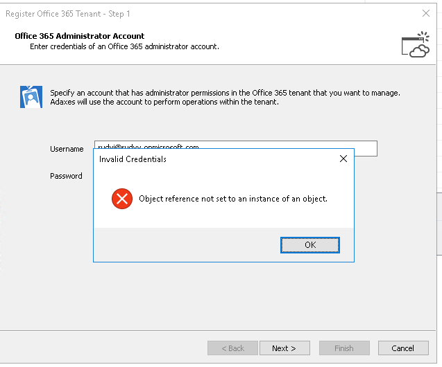

Hello Dmytro,
Could you, please, try to register the tenant in Adaxes? For details, have a look at the following tutorial: https://www.adaxes.com/tutorials_Active ... htm#tenant.
The log does not appear because the tenant is not registered in Adaxes.
by (920 points)
Unfortunately I can't since I don't have admin priveleges in Azure tenant, I'm managing only on-premise AD. But we really need to pull the license info to adaxes.
Is there any other way to troubleshoot this?
Hello Dmytro,
“Object reference not set to an instance of an object.” is a very common error and can occur because of multiple reasons. To troubleshoot the issue, you need to register a tenant in Adaxes. It is not necessarily should be your production tenant. You can create a dummy tenant in Office 365 and then register it in Adaxes without association with any scope of your domain.
by (920 points)
I've created a test tenant and tried to add it. The irony is that I get same error message :lol:

Dear Support,
thanks for your help - we've found the issue. Proxy had to be set up manually under service account - settings set up in Adaxes configuration (proxy) - didn't work.
