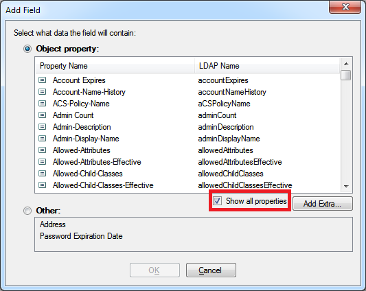

Hello Den,
Enable the Show all properties option in the Add Field dialog.
You can also click Add Extra and type the LDAP name of an attribute (e.g. extensionAttribute3)
Did you restart the Web Interface Customization tool? Are there any warnings shown on startup?
