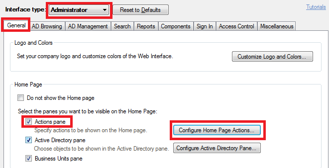

Yes. You can create a Custom Command that will be executed on a User object. Then, you can create a Home Page Action in the Adaxes Web Interface that would always execute this Custom Command for the current user, thus evading the object selection page. To do this:
  2. On the 2nd step of the Create Custom Command wizard, select User.
  3. On the 3rd step of the wizard, add the Run a program or PowerShell script action and paste your PowerShell script.
  4. Finish creation of the Custom Command.
  5. On the computer, where the Web Interface is installed, start the Web Interface Customization tool.
  6. In the Interface type drop-down list, select the Web Interface you want to configure.
  7. Activate the General tab, select the Actions pane option, and click Configure Home Page Actions.

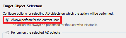

  8. In the dialog box that appears, click Add...
  9. On the 1st step of the Add Home Page Action wizard that appears, select Custom Command.
  10. Select the Custom Command that you created in the drop-down list that appears next to the Custom Command option.
  11. On the 3rd step of the wizard, select Always perform for the current user an click Finish.
This will do the job.

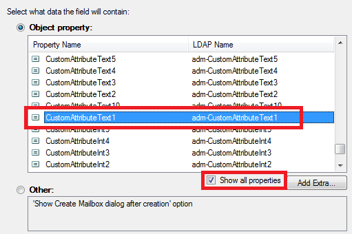

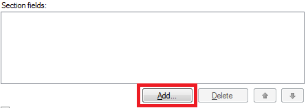

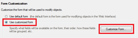

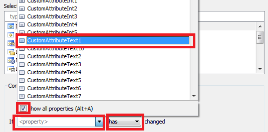

Is there a way to add additional Adaxes Virtual Properties, such as "adm-CustomAttributeText11", ...12, and so on?
In the Web Interface Customization tool I've configured a Customized Form, added a new Field with the "Add Extra..." button called "adm-CustomAttributeText11" and updated my AttributeFriendlyNames2.eng, then ran iisreset. This resulted in my Friendly Name showing up correctly in the "Section Field" of the "Customize Form" dialog box.

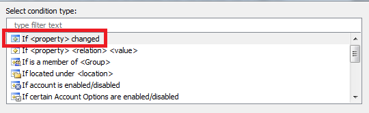

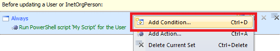

Now I'm trying to create a Business Rule and Add Condition "If changed". When I attempt to select the Condition Parameters my new Virtual Property does not appear in the selection list with "Show all properties" selected.
I also noticed that in the Web Interface I receive an error when clicking onthe new Home Page action after I select the user I want to modify:
Fetal Error
Information about the property 'adm-customattributetext11' was not fetched.
I am going about this the correct way?
Hello Michael,
You cannot add properties like this. Currently, Adaxes provides only 10 custom properties that you can use for text (string) values, which are CustomAttributeText1 through CustomAttributeText10. We'll add 10 new custom text attributes in Adaxes 2013.1.
For now, since you have Exchange installed, you can use the custom properties that are provided by Microsoft Exchange Server. By default, Adaxes displays these properties as ms-Exch-Extension-Attribute-1 through ms-Exch-Extension-Attribute-15. The LDAP names for these properties are extensionAttribute1 through extensionAttribute15. You can use them as any other properties of directory objects.
