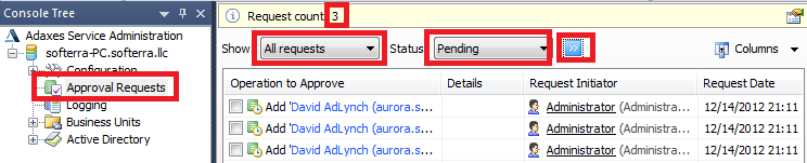

What could cause the issue is that you have too many Approval Requests (over 1000). To check the number of pending Approval Requests:
  2. In the Console Tree, expand the service node that represents your Adaxes service.
  3. Select Approval Requests.
  4. In the Result Pane, select All requests in the Show field and Pending in the Status field.
  5. Press the Apply Filter button.
  6. The number of pending Approval Requests will be shown at the top of the Result Pane.

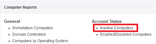

To find all inactive computers in your Active Directory:
  1. Login to Adaxes Web Interface.
  2. Select Reports from the Top Navigation Menu.
  3. On the page that appears, select Inactive Computers under Computer Reports > Account Status.
  4. Specify the number of days during which a computer should be inactive to match the criteria and click Generate.

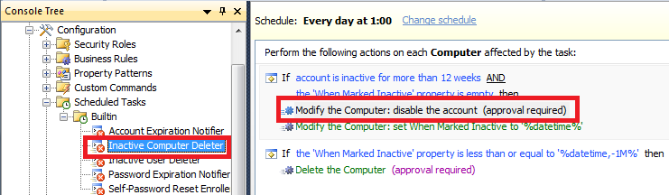

To receive notifications whenever the Inactive Computer Deleter Scheduled Task creates an Approval Request:
  3. Navigate to Configuration \ Scheduled Tasks \ Builtin.
  4. Select Inactive Computer Deleter.

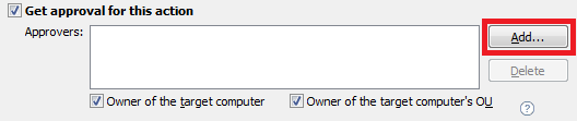

  5. Double-click the Modify the computer: disable the account action.
  6. in the dialog box that appears, click Add... in the Get approval for this action section.
  7. In the dialog box that appears, select your own user account and click OK.
  8. Double-click the Delete the Computer action.
  9. in the dialog box that appears, click Add... in the Get approval for this action section.
  10. In the dialog box that appears, select your own user account and click OK.
  11. Click OK again and save the Scheduled Task.
