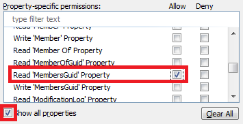

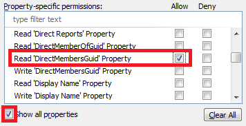

  5. In the Add Permissions dialog that appears, select the Group object type.
  6. Select the Show all properties option.
  7. Select the Read 'MembersGuid' Property and Read 'DirectMembersGuid' Property permissions in the Property-specific permissions section.

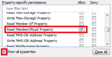

  10. In the Add Permissions dialog that appears, select the User object type.

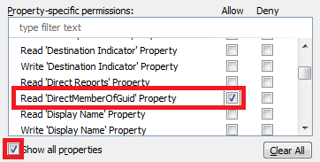

  11. Select the Show all properties option.
  12. Select the Read 'MemberOfGuid' Property and Read 'DirectMemberOfGuid' Property permissions in the Property-specific permissions section.
