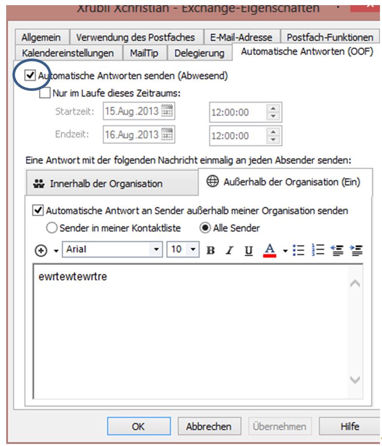

I want to redirect the Approvalrequests to another Person, if the automatic reply function in Exchange is enabled. Can Adaxes read this Attribut from Exchange 2010 so I can create a Business Role and send the request for approval to a other Person when the Attribut is true.

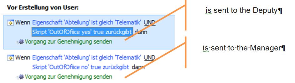

I have one Question to my first post. Is it not possible using two Business rules to solve my Problem.
My Problem is how I get the Status of the OutofOffice Attribute.
What do you think about this idea?

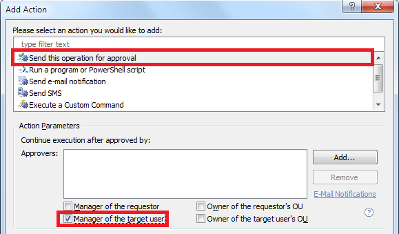

  3. On the 3rd step, add the Send this operation for approval action.
  4. In the Approvers section, select Manager of the target user and click OK.

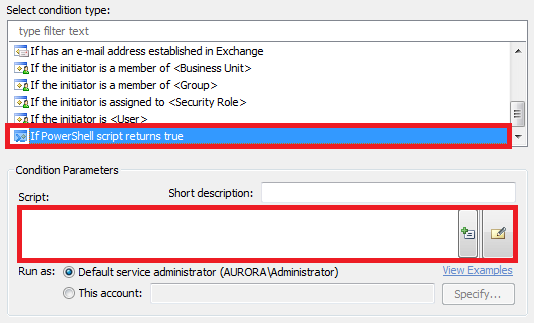

  5. Now, you need to add a condition to send the operation for approval only if the manager has OOF disabled. Double-click Always.
  6. In the dialog box that appears, select the If PowerShell script returns True condition and paste the following script in the Script field.
     $managerDN = $Context.GetModifiedPropertyValue("manager")
     if ($managerDN -eq $NULL)
     # Bind to manager
     $manager = $Context.BindToObjectByDN($managerDN)
     # Get mailbox parameters
         $mailboxProps = $manager.GetMailParameters()
     # Check OOF property
     $automaticReplies = $mailboxProps.AutoReplyConfiguration
     $automaticRepliesStatus = $automaticReplies.AutoReplyState
     switch ($automaticRepliesStatus)
         "ADM_EXCHANGE_OOFSTATETYPE_DISABLED"
         "ADM_EXCHANGE_OOFSTATETYPE_ENABLED"
         "ADM_EXCHANGE_OOFSTATETYPE_SCHEDULED"
             # Check date
             $startTime = $automaticReplies.StartTime
             $endTime = $automaticReplies.EndTime
             $now = Get-Date
             if (($now -lt $startTime) -or ($now -gt $endTime))
    The above script returns $True when the new user's manager has OOF disabled or when the manager does not have a mailbox at all.

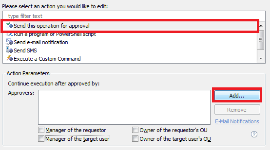

  9. Now, you need to create a new set of actions and conditions that will send the operation for approval to another person if the manager is out of office. Click the Add action to a new set link at the bottom.
  10. Select the Send this operation for approval action.
  11. In the Approvers section, click Add and select the person that will substitute the manager while he is out of office.
  12. Click OK.
  13. Now, you need to add a condition to send the operation for approval only if the manager has OOF enabled. Double-click Always.
  14. In the dialog box that appears, select the If PowerShell script returns True condition and paste the following script in the Script field.
     # Bind to manager
             # Check date
             $now = Get-Date
    The above script returns $True when the new user's manager has OOF enabled or when no manager is specified for the user.
