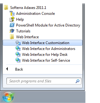

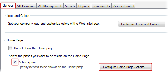

It looks like you deleted the built-in Deprovision command and created another one with the same name. Custom Commands are referred to using their unique IDs, not names. So, if you want to use your command instead of the built-in one, you need to delete the old home page action and create a new one that will execute your custom command:
  2. In the Interface type drop-down list, select the Web Interface that you want to configure.
  4. Delete the Deprovision action from the list.
  5. Click Add and follow the following steps to create a new action that will execute your command: http://www.adaxes.com/tutorials_WebInte ... #executecc

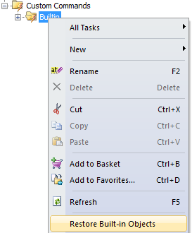

BTW, if you need to restore the built-in command, right-click the Builtin container located under Custom Commands, and select Restore Built-in Objects:
