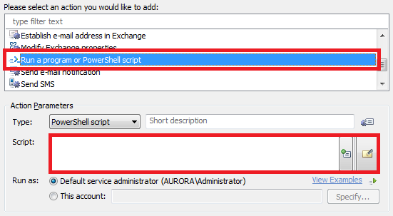

To create a Custom Command that launches the script on a group:
  2. On the 2nd step of the Create Custom Command wizard, select the Group object type.
  3. On the 3rd step, add the Run a program or PowerShell script action and paste the above script in the Script field.

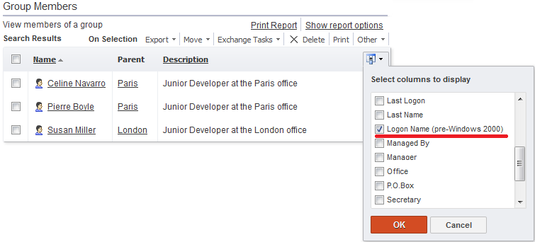

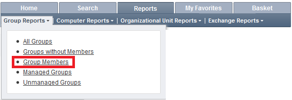

Alternatively, you can use the functionality built in Adaxes. One of Adaxes builtin reports, Group Members report, allows you to get a list of members of a group.
The list is presented in the form of an Active Directory object list, where you can select the columns to display and perform various operations on group members.
