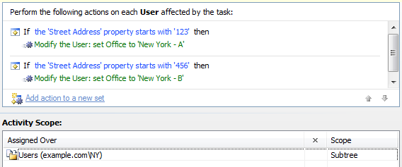

  1. I'd like to run a script that will check the address to see if it points to A or B.(I'd like this in report form so I can know how many records we have).
It's not quite clear what the report must include. Should it be only the users whose Office / Street Address mismatch or what?
create a scheduled task that will check to see if the street address contains 123 and Modify the user: set office to Office: New York - A
We believe it should be something like this:

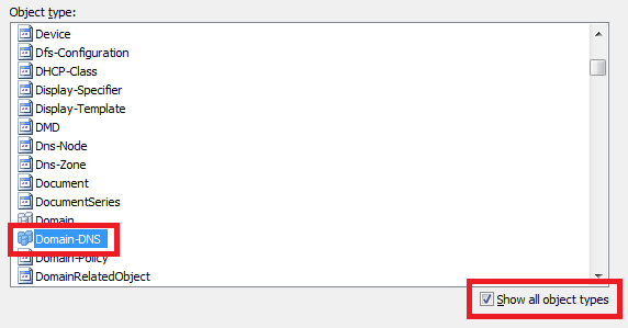

  2. On the 3rd step of the Create Scheduled Task wizard, select Show all object types.
  3. Select the Domain-DNS object type. Assigning the task on a domain gives you the advantage of running the script only once per a Custom Command run.

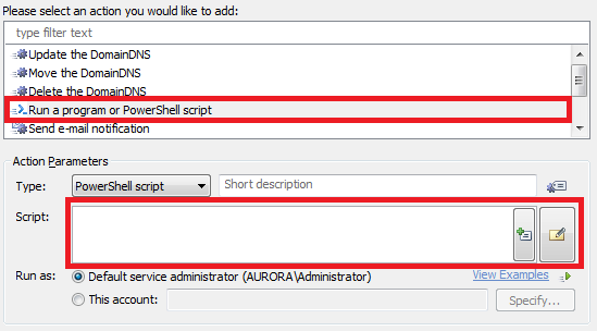

  4. On the 4th step, add the Run a program or PowerShell script action and paste the script in the Script field.
  5. In the script, modify the following to match your requirements:

  6. On the 5th step, include any of your AD domain in the Activity Scope of the Task.
The script:
