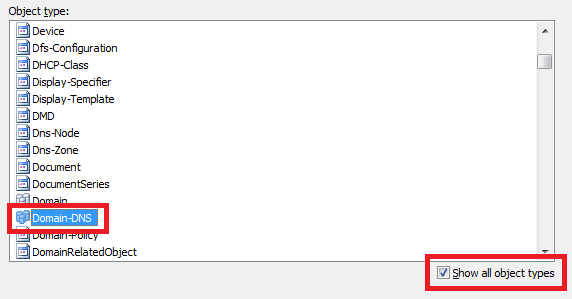

To use it with Adaxes, you'll need to create a Custom Command (to be able to launch it on demand) or a Scheduled Task (to launch it on a certain schedule). To create a Custom Command or a Scheduled Task that launches the script and generates a report:
  1. Create a new Custom Command or Scheduled Task.
  2. On the 2nd step of the Create Custom Command wizard,
    - or -
    on the 3rd step of the Create Scheduled Task wizard,
    select Show all object types.
  3. Select the Domain-DNS object type.

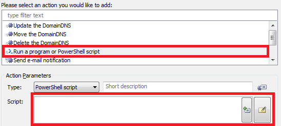

  4. At the next step, add the Run a program or PowerShell script action and paste the above script in the Script field.
  5. At the final step of the Create Scheduled Task wizard, include any of your AD domains in the Assignment Scope.
