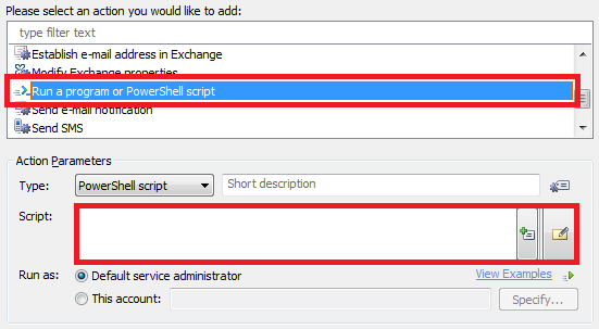

For your task, you can, for example, create a Custom Command that can be executed on a distribution list to find out the time when the distribution list was last sent to. To create such a Custom Command:
  2. On the 2nd step of the Create Custom Command wizard, select the Group object type.
  3. On the 3rd step, add the Run a program or PowerShell script action and paste the above script in the Script field.
