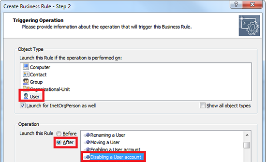

I have a business rule "When a user is disabled"
If the operation succeeded AND
the User is located under the...... then
Move the User to.....
Modify the user: set Description to...

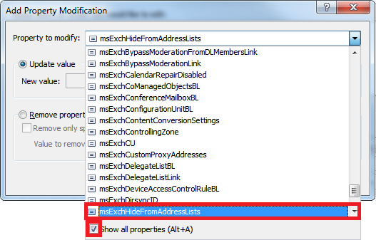

The issue here is that, before we disable a User we remove group membership from all groups except "Domain Users" and set the "MSExchHideFromAddressLists" AD property to "True". How can I add this to my business rule above, so this is automated?

It is possible to do what you need with the help of Business Rules.

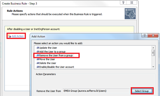

  1. Create a Business Rule that will be executed after disabling a user account.
  2. To automatically remove the disabled user from a specific group, you need to add the Remove the User from a group action to your Business Rule.

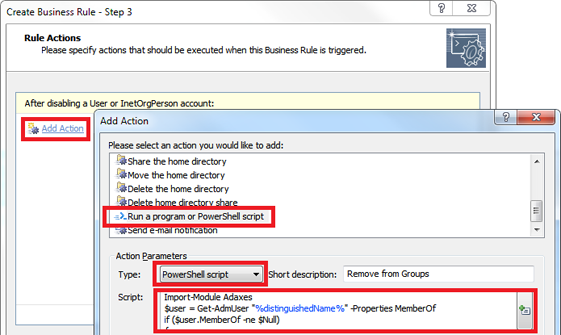

    Alternatively, if you want to remove disabled users from all groups except 'Domain Users', you can add Run a program or PowerShell script action to your Business Rule that will execute the following PowerShell script:
     Import-Module Adaxes
     $user = Get-AdmUser "%distinguishedName%" -Properties MemberOf
     if ($user.MemberOf -ne $Null)
         foreach ($groupDN in $user.MemberOf)
             Remove-AdmGroupMember $groupDN -Members $user  -Confirm:$False
    NOTE: To use this script, you need to install the Adaxes PowerShell Module on the computer, where the Adaxes service is running. Adaxes PowerShell Module is installed with the same installation package as used to install Adaxes service.

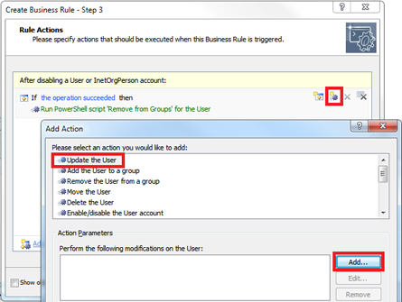

    1. To set the MSExchHideFromAddressLists property to True, you need to add Update the user action to your Business Rule:
    And set the msExchHideFromAddressLists property to True.

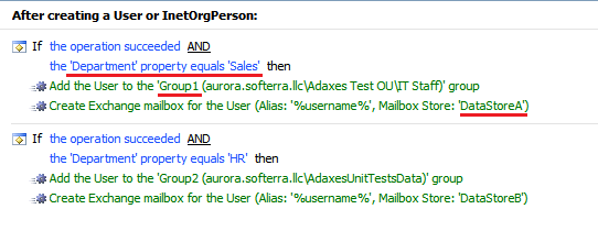

3 - Then there are the Exchange storage groups. We have 5 exchange storage groups. User mailbox should be placed depending on which Security group he is a member of when he is created(I know how to achieve this, the problem is... see picture below). There are multiple Security groups belonging to single exchange storage groups. If i could change the AND to a OR only in this line(instead it changes all AND to OR), it would solve the issue!

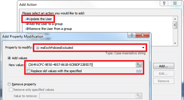

I would like to have the Check-mark "Automatically update e-mail addresses based on e-mail address policy" removed
To clear this check box, just set the msExchPoliciesExcluded property to {26491CFC-9E50-4857-861B-0CB8DF22B5D7}. Read more.
You can do this automatically with the help of a Business Rule that is triggered after user creation, or after mailbox creation.

User mailbox should be placed depending on which Security group he is a member of when he is created.
It is impossible to do it the way you want. I suggest you create mailboxes right after you add users to groups.

I want to auto-populate users group membership after creation
You can automatically add newly created users to groups using Business Rules.
For more details, see Automatically Add Users to Groups by Department.

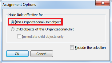

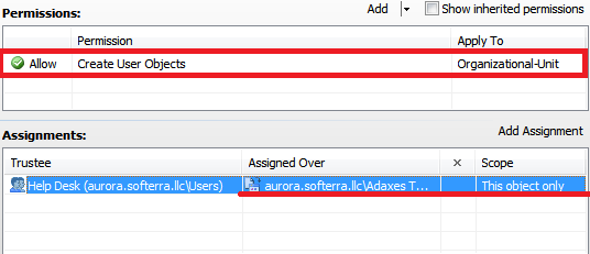

When I try to create a user from Adaxes Help-Desk(logged in as a HR user), I just get a red line at the top saying "Access denied!".
This error occurs because the user doesn't have the rights to create new user accounts in the selected OU.
You need to assign this user to a Security Role over the OU in which you are trying to create a new account:
For details, see Grant Rights to Create Users.
