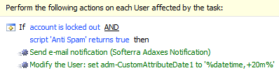

Actually, you can do this with a single Scheduled Task instead of 2. Also, we recommend using Adaxes virtual attributes because, unlike Exchange Custom Attributes, they can store date/time values, which will make the script faster to complete and much simpler. Adaxes virtual attributes are not stored in AD, but can be used the same as any other attributes of AD objects. Date/time values are stored in the following attributes: CustomAttributeDate1 ... CustomAttributeDate5.
Thus, the Scheduled Task will look something like this:
The 'Anti Spam' script used in the Scheduled Task is as follows:
    $mailTime = $Context.TargetObject.Get("adm-CustomAttributeDate1")
# Check if the $mailTime is older than the current time
if ($mailTime -lt [System.DateTime]::Now)
    # Clear the custom attribute
    $Context.TargetObject.Put("adm-CustomAttributeDate1", $NULL)
    # Exit from script
