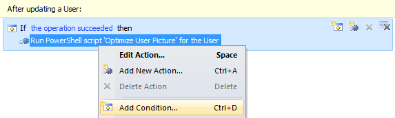

  4. In the script, $maxWidth and $maxHeight specify the maximum width and height of the picture allowed. Modify them to meet your requirements.
  6. Now, you need to specify conditions for the script to be run only when a user's picture is modified. To do this. right-click the action you've just added and click Add Condition.

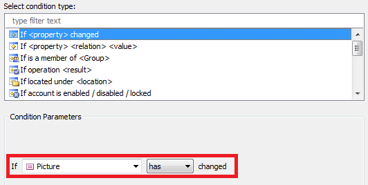

  7. Select the If changed condition type.
  8. Specify If Picture has changed.
  9. Click OK.

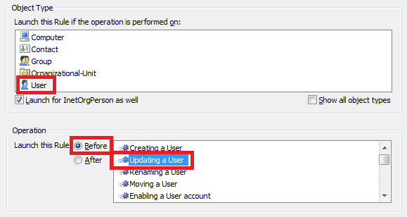

This occurs because the file that you are trying to upload exceeds the limit of 100 kB allowed by Active Directory. To workaround this, you'll need to resize the picture before updating the Picture attribute so that it does not exceed the limit. Since the script will resize the picture anyway, you can remove the Business Rule triggered per our previous instructions and replace it with a Business Rule created per the instructions below:
  2. On the 2nd step of the Create Business Rule wizard, select User and Before Updating a User.
  3. On the 3rd step, add the Run a program or PowerShell script action and paste the following script in the Script field:

  6. Now, you need to specify conditions for the script to be run only when a user's picture is modified. To do this, double-click Always.
  9. Click OK.
