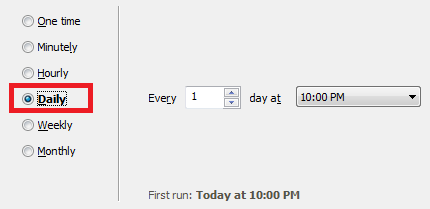

  2. On the 2nd step of the Create Scheduled Task wizard, configure it to run daily, say, at the end of the work day.

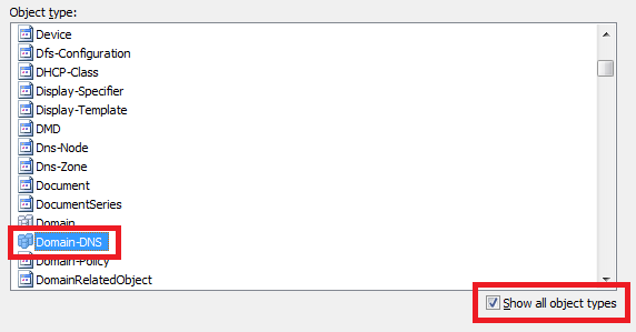

  3. On the 3rd step, select the Show all object types option.
  4. Select the Domain-DNS object type. Running the Task on a domain allows to run the script only once per a Task run.

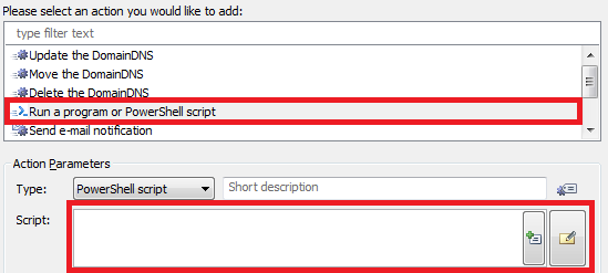

  5. On the 4th step of the wizard, add the Run a program or PowerShell script action and paste the following script in the Script field:
     $numDays = 1 # set to 0 to output all records
     $subject = "Adaxes errors for the last $numDays days" # TODO: modify me
     $htmlReportHeader = @"
     <b>Adaxes errors for the last $numDays days</b><br/><br/>
     <table border="1">
         <tr>
             <th>Start Time</th>
             <th>Completion Time</th>
             <th>Initiator</th>
             <th>Target Object</th>
             <th>Target Object Type</th>
             <th>Operation</th>
             <th>Execution Log</th>
         </tr>
     "@ # TODO: modify me
     $htmlReportFooter = "<hr /><p><i>Please do not reply to this e-mail, it has been sent to you for notification purposes only.</i></p>" # TODO: modify me
     function GetExecutionLog ($logEntryCollection, $executionLog)
         $executionLog += "<ul>"
         foreach ($logEntry in $logEntryCollection)
             # Get the operation info
             $type = $logEntry.Type
             $message = $logEntry.Message
             $source = $logEntry.Source
             # Build report record
             $messageBuilder = ""
             if (-not([System.String]::IsNullOrEmpty($source)))
                 # Add the source to the message
                 $messageBuilder += "$source`: "
             $messageBuilder += "$type - $message"
             # Encode all HTML tags
             $messageBuilder = [System.Web.HttpUtility]::HtmlEncode($messageBuilder)
             # Add the message to the report
             $executionLog += "<li>$messageBuilder"
             # Add subentries, if any
             $subEntries = $logEntry.SubEntries
             if ($subEntries.Count -ne 0)
                 $executionLog = GetExecutionLog $subEntries $executionLog
             $executionLog += "</li>"
         $executionLog += "</ul>"
         return $executionLog
     # Bind to the Service Log
     $path = $Context.GetWellKnownContainerPath("ServiceLog")
     $serviceLog = $Context.BindToObject($path)
     # Set the start and end dates
     $generalLog = $serviceLog.GeneralLog
     if ($numDays -ne 0)
        $generalLog.StartDateTime = (Get-Date).AddDays(-$numDays)
        $generalLog.EndDateTime = Get-Date
     # Get the log records
     $log = $generalLog.Log
     $records = $log.GetPage(0)
     $errorCount = 0
     foreach ($record in $records)
         if (($record.State -eq "OPERATION_STATE_FAILED_CAN_CONTINUE") -or ($record.State -eq "OPERATION_STATE_FAILED_NO_CONTINUE"))
             # Add the log record to the report
             $recordStartTime = $record.StartTime
             $recordCompletionTime = $record.CompletionTime
             $recordInitiatorName = $record.Initiator.Name
             $recordTargetObjectName = $record.TargetObjectName
             $recordTargetObjectType = $record.TargetObjectType
             $recordDescription = $record.Description
             # Get Execution Log
             $executionLogEntries = $record.GetExecutionLog()
             if ($executionLogEntries.Count -eq 0)
                 $executionLog = "Execution Log is empty"
                 # Add Execution Log to the report
                 $executionLog = GetExecutionLog $executionLogEntries ""
             $htmlReportHeader += "<tr valign='top'><td>$recordStartTime</td><td>$recordCompletionTime</td><td>$recordInitiatorName</td><td>$recordTargetObjectName</td><td>$recordTargetObjectType</td><td>$recordDescription</td><td>$executionLog</td></tr>"
             $errorCount++
     if ($errorCount -ne 0)
         # Build HTML report
         $htmlBody = $htmlReportHeader + "</table><p>Total Errors: $errorCount</p>" + $htmlReportFooter
         # Send report
         $Context.SendMail($to, $subject, $NULL, $htmlBody)
