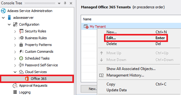

  3. Navigate to Configuration\Cloud Services and select Office 365.
  4. In the Result Pane on the right, right-click the tenant marked in red and then click Edit. image.png

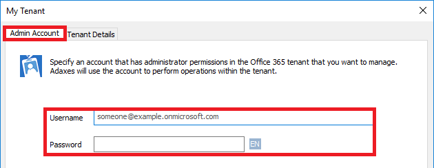

  6. Click OK and save the changes.
  7. Repeat steps 2-6 for each instance of Adaxes service you have.
