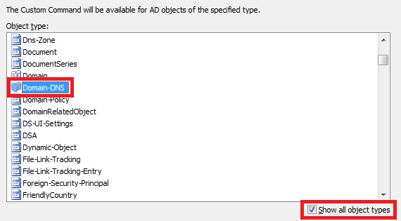

  2. On the 3rd step of the Create Scheduled Task wizard, select the Show all object types option.
  3. Select the Domain-DNS object type. Running the Task on a domain allows to run the script only once per a Task run.

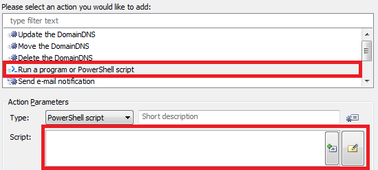

  4. On the 4th step of the wizard, add the Run a program or PowerShell script action and paste the following script in the Script field.
