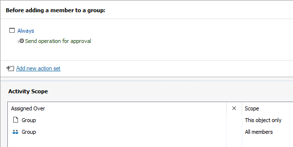

Hello!
Do we understand correctly, that you would like to have an approval request created before adding users to groups which are members of another group? In this case, a Business Rule triggering Before Adding a member to a Group can be used. If you need to submit the operation for approval when users are added to the group itself and to the nested groups then you will need to specify the group itself and its members in the activity scope of the Business Rule. Finally, the Business Rule should look like the following:
If this is not what you meant, please, describe the entire workflow in all possible details. Live examples would be much appreciated.

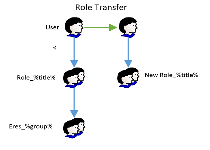

This is actually backwards. The Role_%title% is a member of the ERES_%group%.
Here is a picture!
by (70 points)
So I need a email sent and approval requested for the ERes_%group% manager when a user is added to a Role_%title% group that is a member of the ERes_%group% unless the user was already indirectly a member of the group. And an email sent and approval requested for removal as well.
by (16.6k points)
Thank you for the clarification. Here is the solution we recommend:
For adding users to Role groups
When a user is added to a Role group, a Business Rule will trigger. It will send an email notification (not an approval request) to the manager of the Eres group the Role group in question is a member of and check whether the user is currently a member of the Eres group. If the user is a direct member of the Eres group, they will be added to the new Role group right away and no approval requests will be created. If the user is not a direct member of the Eres group, an approval request will be sent to the Manager of the Eres group.
For removing users from the Role groups
When a user is removed from a Role group, a Business Rule will trigger. It will send an e-mail notification (not an approval request) to the Manager of the Eres group the Role group in question is a member of and check whether the user is currently a member of any other Role groups in the Eres group. If the user is a member of other Role groups, an approval request will be sent to the manager of the Role group only and the user will be removed only from this group once the request gets approved. If the user is not a member of any other Role groups in the Eres group an approval request will also be sent for removing the user from the Eres group to the group Manager (as a result once the requests are approved, the user will get removed from both the Eres and the Role groups).
Please, feel free to provide any additional details or corrections.
