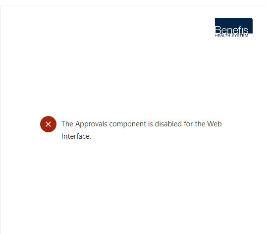

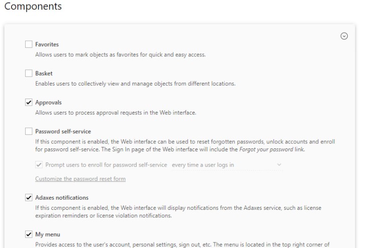

I have a web view set up where the user is locked down to only seeing thier approvals. When they get a email notification, and click on the approve or deny link, I get this error:image.png However in the configuration web tool I have this set: image.png I do not hae a security role defined for these users as they will not need access to manage anything in Adaxes just approvals. I don't see a permission that would grant this access but I am wondering if there is something I am missing.
by (1.2k points)
The behavior is not related to security roles and permissions. The issue occurs because the Web interface you are taken to when attempting to process an approval request does not have the Approvals component enabled. Make sure that the Web interface you are checking the settings for in the Web interface configurator is the one you are taken to when processing requests. Also, you can check/change the URL of the Web interface being used following the steps from this article: https://www.adaxes.com/help/RegisterWebInterface.
