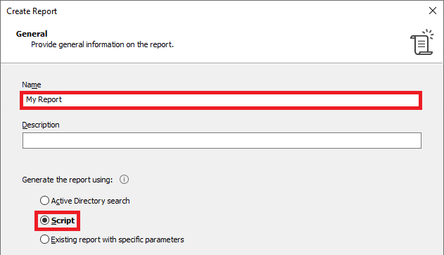

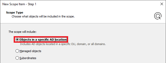

  8. Specify scope settings and click Finish.

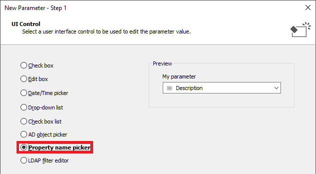

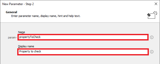

  12. Specify a parameter name and display name (e.g. propertyToCheck and Property to check). image.png

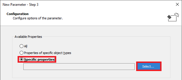

  15. Specify the properties that will be available for selection to generate the report.
