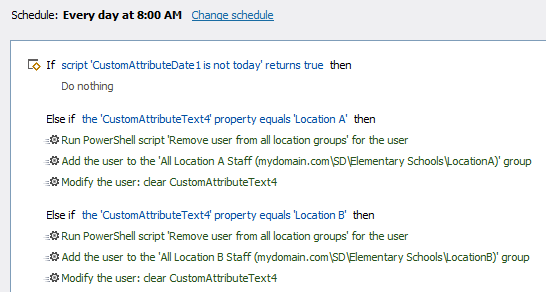

I also created the custom task that runs daily at 8am. The task is laid out like this
The task will only be able to execute the actions in the Else If block because the condition the 'CustomAttributeDate1' property equals '%datetime%' can never be met. To compare dates you need to use the following script from our repository: https://www.adaxes.com/script-repository/check-whether-date-in-object-property-is-today-s528.htm. For your case, you will need to replace this line in the script
$Context.ConditionIsMet = $compareDate.Date -eq $currentDate.Date
with the following one:
$Context.ConditionIsMet = $compareDate.Date -ne $currentDate.Date
Also, there is no need to check CustomAttributeText4 for being empty as you have the equality condition for the attribute. Finally, the Scheduled Task will look as follows: image.png
