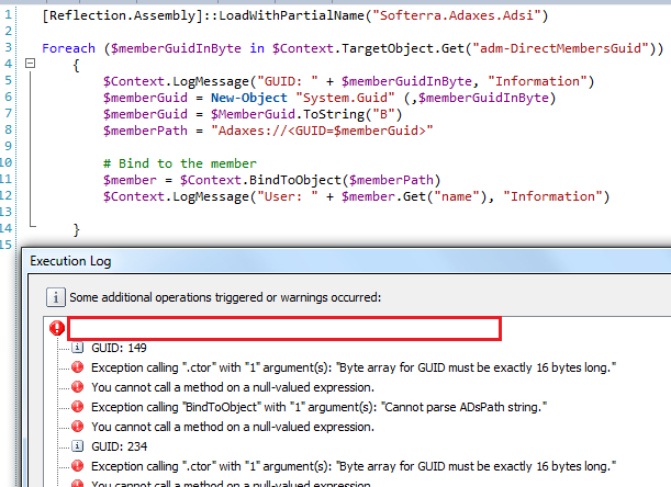

I have replicated the core error with a cutdown script as shown in the below screenshot - it looks as if the GUID coming back is being sliced up as there is ony one member in my test group but it is looping through multiple portions of the GUID?

Sorry, there was a small error in the script. We've modified the script in the post above, just recopy it and try again.
Also, in your version of the script, you have a statement that loads the Adaxes ADSI DLL. Remove it. The DLL is used everywhere in Adaxes to perform any operations in Active Directory, so it is already loaded into all PowerShell sessions created by Business Rules, Custom Commands and Scheduled Tasks.
Perfect - thanks very much.
To confirm to anyone reading this because they have a similar issue the change was adding:- $Context.TargetObject.GetEx("adm-DirectMembersGuid")).
