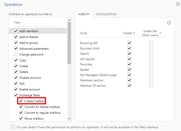

Since updating from Adaxes 2020.1 to 2021.1 we are no longer able to create Mailboxes from within the web Ui with just an error this operation is not allowed in the web interface.
any ideas on how to enable this again? the security role for the admins is set to full control on all object trypes.
Have a look at the following tutorial: https://www.adaxes.com/tutorials_WebInterfaceCustomization_DisallowCertainOperationsOnADObjects.htm. You need to enable the Create mailbox operation in the Web interface settings. image.png If this does not fix the issue, please, post here or send us (support@adaxes.com) a screenshot of the error you are facing. Any additional details will be much appreciated.
As per our check, the issue occurred if the Move mailbox operation was disabled in the Web interface settings alongside having the Create mailbox operation enabled. The issue was fixed in Adaxes 2021.1 Update 3.
