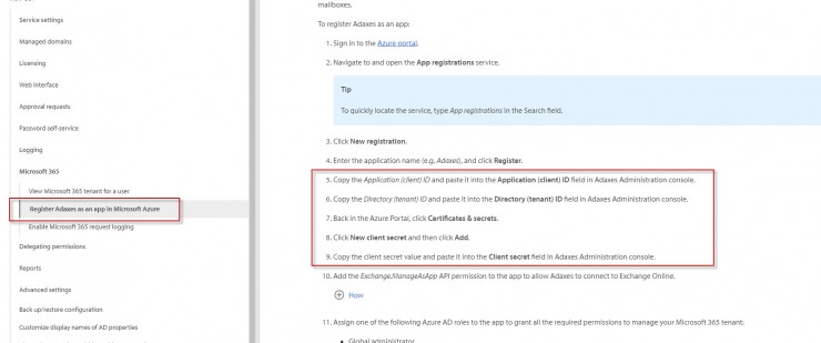

Our Adaxes Microsoft 365 Tenant was created before we copmpleted the "app registration" in Azure. Which means that in the instructions for "Register Adaxes as an app in Microsoft Azure", we did not do steps 5-9 (screenshot attached of steps).

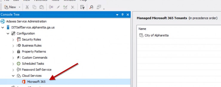

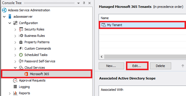

  3. Navigate to Configuration\Cloud Services and select Microsoft 365.
  4. In the Result Pane on the right, select your tenant and then click Edit below. image.png

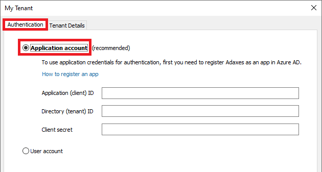

  5. Activate the Authentication tab.
  7. Enter the required data according to the article you referenced.
  8. Click OK.

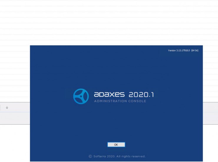

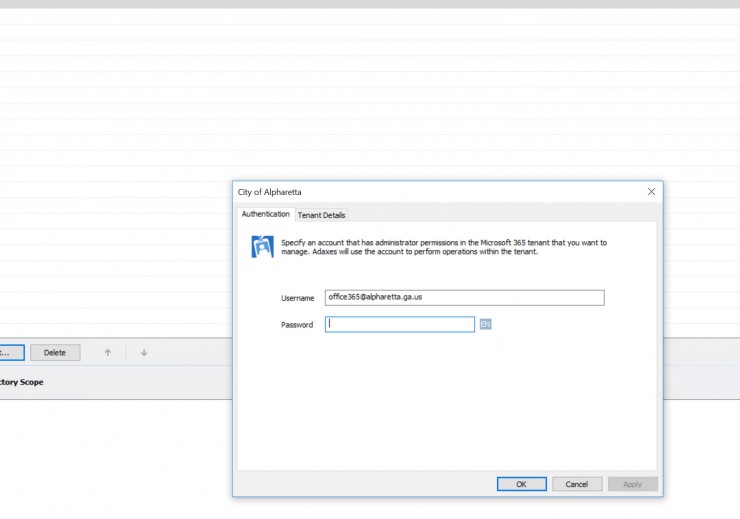

I do not have that option when I edit the tenant. See screenshots of how it looks as well as our current version of Adaxes.
I do not have the 'application account' options when I go to the 'authentication' tab. Is there something that we can do to get that option so I can then follow your instructions?
by (306k points)
The thing is that the feature was introduced in Adaxes 2021.1. Unfortunately, there is no possibility to use an Azure application for your Microsoft 365 tenant in Adaxes in version 2020.1. To be able to use the functionality, you need to upgrade. For details, have a look at the corresponding section of our installation guide: https://www.adaxes.com/help/InstallationGuide/#upgrade.
