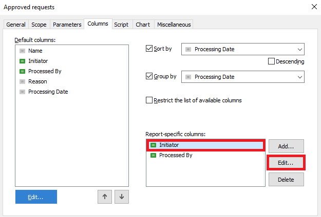

  13. Activate the Columns tab.
  14. In the Report-specific columns section, select the Initiator column and click Edit. image.png

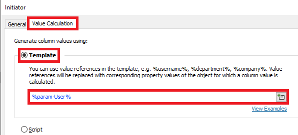

  15. Activate the Value calculation tab.
  16. Select Template.
  17. In the Template field, specify a value reference for the parameter created on step 11 (e.g. %param-user%). image.png

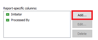

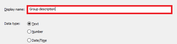

  20. Specify a display name for the column that will contain group description and click Next. image.png

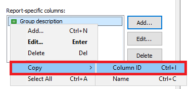

  25. Paste the below script into the corresponding field. In the script, the $groupDescriptionColumnID variable specifies the identifier of the custom column that will contain group description. To get the identifier:
    • On the Columns tab, right-click the column in the Report-specific columns section.
    • The identifier will be copied to the clipboard.
