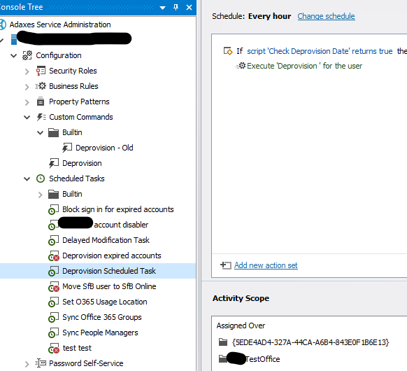

Currently the task is set to run against an unknown OU (the 5EDE OU shown here:) Screenshot 2022-04-21 .png

I have tried adding a test office OU to the 'assigned over' section, however even when I set the 'deprovision date' in the 'Modify user' section of the web console to be a later date, it will execute the deprovision command 100% of the time when I run the script (so I presume it is returning true 100% of the time?)
This can happen, for example, if the OU got deleted. You can safely remove the item from the Activity Scope of the scheduled task and add required ones.

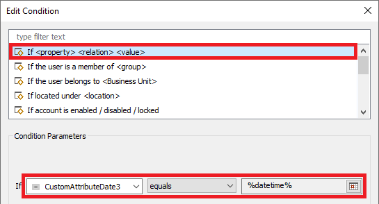

The script is wrong and will never work as desired. If you are using Adaxes version 2021.1, no scripts are required. You can use the If condition as follows: image.png If you are using an older version, here is the script that will do the trick:
