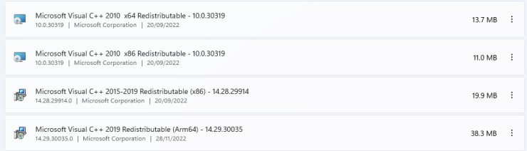

Thank you for clarifying. For troubleshooting purposes, please, specify the following:
  • The build number of Windows OS you have on the virtual machine.
  • The version of Adaxes you installed. You can check it in the list of installed programs.
  • The versions of the Microsoft Visual C++ Redistributable applications. image.png

Hello, I tried the repair option, but the problem still exists. These are the installed Visual C++ versions:
Hello Matthias,

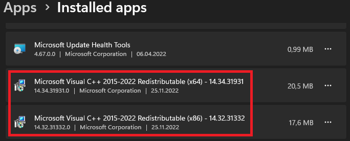

According to the screenshot, the version of Microsoft Visual C++ you have is not the latest one. Please, try upgrading the components and check whether the issue persists.
by (40 points)
after installing the latest version of C++ everything works fine. Thx for your support!
