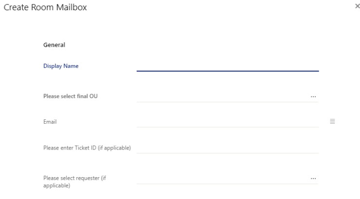

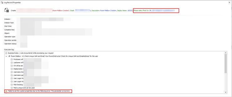

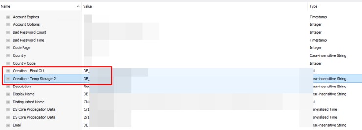

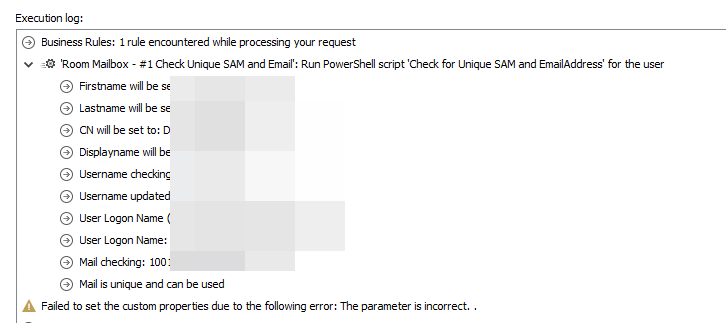

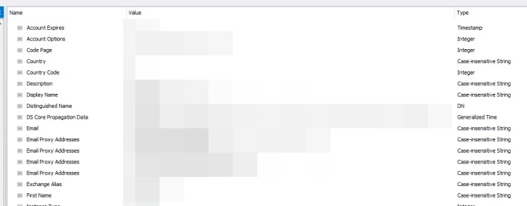

First try is with email value set during creation and thsi outcome image.png

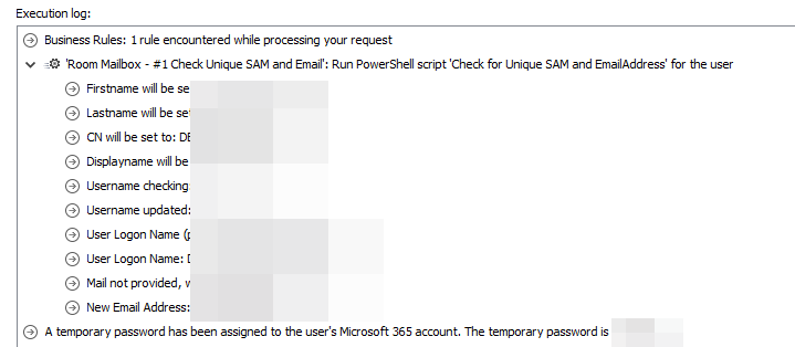

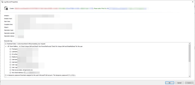

The field Please select final OU is stored in adm-CustomAttributeObject1
This is my script, running before user creation

The functions used in the script are in a separate file, so we have no possibility to provide any analysis. Please, post here or send us (support@adaxes.com) the contents of the functions.ps1 file in TXT format.
For your information, using such an approach is not recommended. The thing is that you will need to keep the file in mind and act accordingly when the corresponding changes are made. For example, if you decide to move the file to a different location, you will need to update the path in the script. Also, you will need to make sure that all the Adaxes services you have must have access to the file.
by (2.7k points)
Sure, here. And I know - but this file will never be moved , only be updated.
I am using this functions for several scripts in Adaxes and its much easier to maintain one file, instead of going into each Adaxes rule and might forget one :)

One more information I noticed For the ceration with warning, both values are not set
  • adm-CustomAttributeObject1
  • adm-CustomAttributeText3
What exactly do you mean by not set? Were the property values not specified on the creation form?
by (2.7k points)
adm-CustomAttributeObject1 is a mandantory field and always set, however the warning object has this not set
Thank you for clarifying. It means that the script influences the property values somehow. We will check the lot and get back to you as soon as there are any updates or additional information is required.
The issue occurred because the custom attribute value was not properly specified in case of unique email. to remedy the issue, replace $newMail with $mail in the below code.
if($uniqueEmail -eq $true)
    $Context.LogMessage("Mail is unique and can be used", "Information")
    $Context.SetModifiedPropertyValue("adm-CustomAttributeText3", $mail)
} else {
by (2.7k points)
Oh wow, how can I thank you for this? <3 tiny but big impacted issue ... doing a test currently and looking good so far

Two more questions about this issue
  1. Why is even adm-CustomAttributeObject1 not set? This value is not modified during Powershell Script
  2. Is it possible to improve warning level like above and add a line number for better reference?
As per our tests it worked fine. Please, provide us with a screenshot of the corresponding execution log.
Also, we fixed some coding mistakes in your script. Give the below version a try. It will probably give you more details insight on the actual issue.
