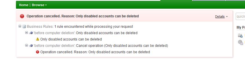

I would like to inform the initiator about the canceled action.
Is there a way to show an error message?

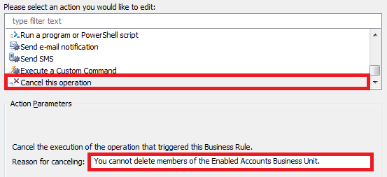

Hello Horst,
The reason for operation cancellation can be specified in the settings of the Cancel operation action.
The reason will be displayed in the Execution log.
The message for the initiator is ok (wimessage), but the log does not show the same information (logmessage)

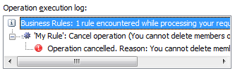

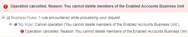

Hello Horst,
The information is displayed in the Operation execution log. To view it, double-click the log record.

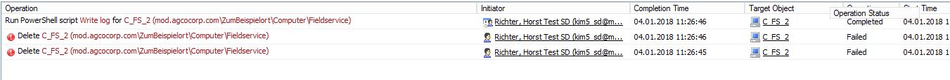

I'm testing your PS script to export logging data into csv. The "original" script does' not list the status and not this specific information.
Is is possible to add these fields with "household remedies" or do I have to use an external tool?
Hello Horst,
We have updated the script in our repository. Now the CSV file will also contain operation state. You can find the script here: http://www.adaxes.com/script-repository ... v-s183.htm.
