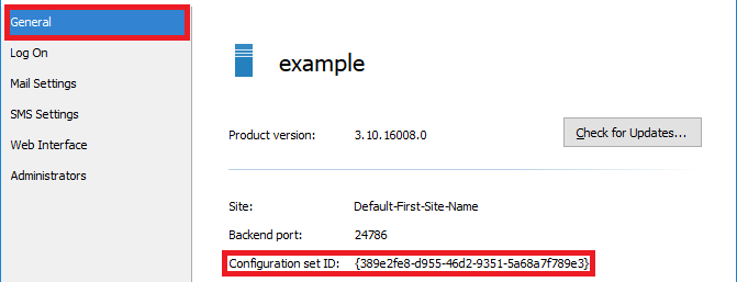

  • - specifies the configuration set identifier of an existing Adaxes service instance to which the Web Interface will be connected (e.g. {dd93c976-49ce-4a7c-b54e-78d0fa6b3529}). To get the identifier:
    2. In the Console Tree, right-click your service node and then click Properties in the context menu.
    3. The identifier will be displayed on the General tab.

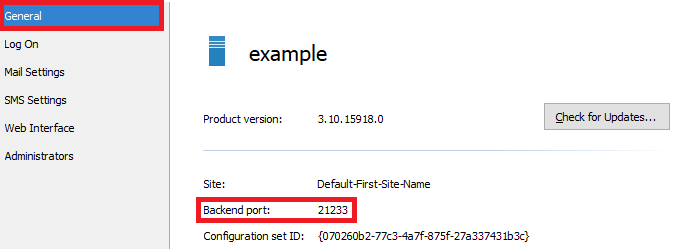

How to identify the port used by an Adaxes service
  2. In the Console Tree, right-click the service node.
  4. The backend port will be displayed on the General tab.
