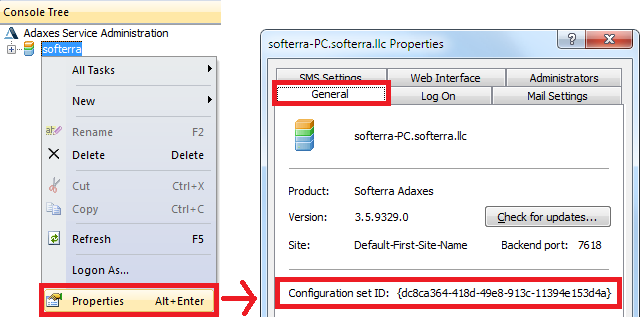

Is there anyway to change the association\service that a web server will use post-install?
Yes, this is possible. For this purpose, you need to manually edit the configuration file for each of your Web Interfaces:
  1. Open the folder that contains the Adaxes Web Interface site you want to configure. By default, Adaxes Web Interface sites are installed to the following folders:
    • Administrators:
    • Help Desk:
    • Self-Service:
  2. Find the Web.config file and open it with a text editor.
  3. Locate the following XML element: adaxesConfigurationSetId="<set_id>"
    where the <set_id> value will be the ID of the configuration set for the service that you specified during Web Interface installation (or it can be empty in case if Adaxes Web Interface is configured to use the service on the local computer).
  4. Enter the ID of the configuration set that you want Adaxes service to connect to.
    To get the ID of a configuration set:
    • Open Adaxes Administration Console.
    • In the Console Tree, locate an Adaxes service joined to the configuration set that you want Adaxes Web Interface to connect to.
    • Right-click the service and click Properties.
    • Activate the General tab.
    • The ID of the configuration set will be displayed in the Configuration set ID field.
  5. When done, save the file.
