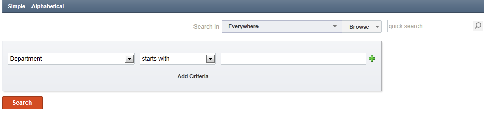

I'd like to be able to have my default search view of a particular URL I created go from this:

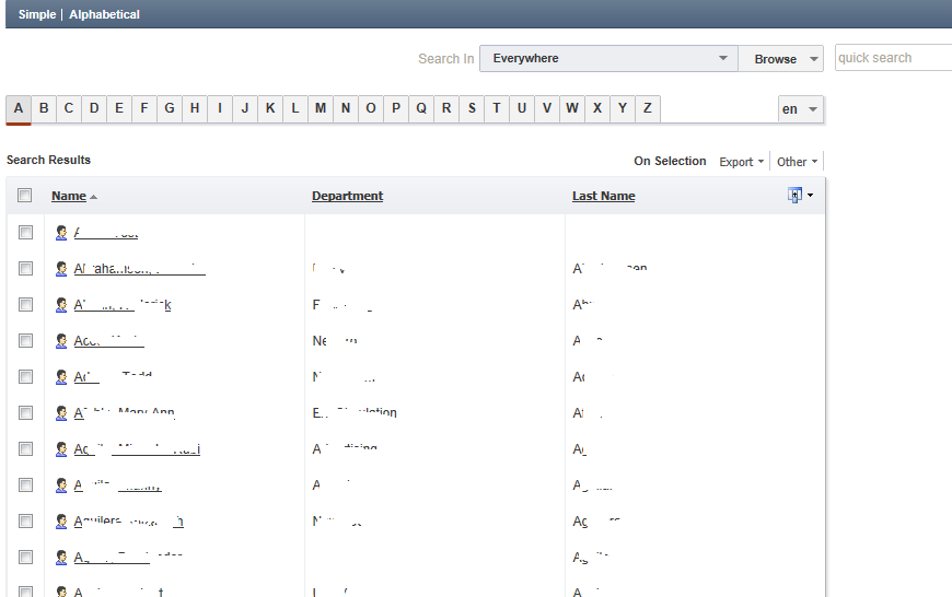

To this:
So that it already starts out with an alphabetical list. Right now it defaults to a department simple search which isn't helpful.

Yes that is basically correct. I created a new Adaxes web portal called Directory that essentially replaces our company's outdated phone search portal.
I want to have the default page display result data initially without the user having to enter anything. In other words, I'd like it if the default page started displaying the A alphabetical list first. Should the user wish to refine the search by simple or choosing a different letter of the alphabet, that would be the first step the user would take.
Currently, you cannot make alphabetical search the default search page in Adaxes.
The only thing you can do is to publish the link to the search directory by adding SearchAlphabetical.aspx at the end. In this case, when users sign in to the web interface, they will be redirected directly to the alphabetical search.
So, for example, if you installed Adaxes Web Interface on computer named computer.domain.com, and you chose to use the Self-Service Web interface to use as the search directory, the URL will be:
http://computer.domain.com/AdaxesSelfService/SearchAlphabetical.aspx
