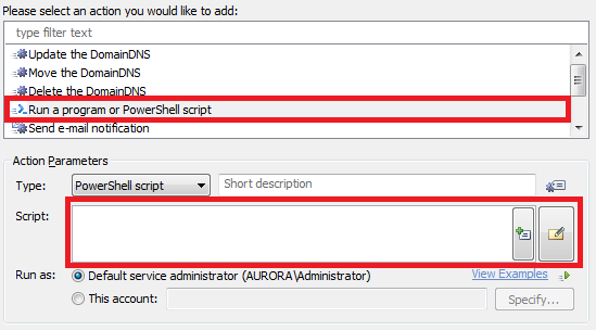

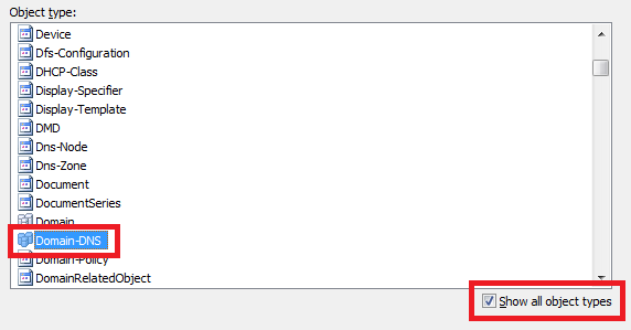

That's the main rason why the script didn't work. All scripts in Server-Side Scripting are intended to be launched from Custom Commands, Scheduled Tasks and Business Rules, because the article deals with server-side scripting, that is, scripting on the side of Adaxes service. However, these are just samples, and it is, of course, possible to create scripts that can be launched from PowerShell ISE / PowerShell Console or as scripts in PS1 files.
To be able to launch the sample script, you need to create a Scheduled Task or a Custom Command that can be launched on a domain object, and launch the script using the Scheduled Task / Custom Command. To create such a Scheduled Task:
  2. On the 3rd step of the Create Scheduled Task wizard, select Show all object types.
  3. Select the Domain-DNS object type. Assigning a Task on a domain allows to perform the actions defined for the Task only once per a Task run.
  4. On the 4th step, add the Run a program or PowerShell script action and paste the PowerShell script from the sample in the Script field.
  5. On the 5th step, assign the Task over any of your AD domains.
