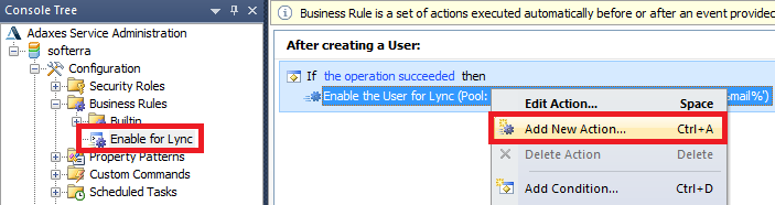

When is the Business Rule triggered? We suspect that if the Business Rule is triggered after creating or updating the user, this can be an issue in replication. It is possible that Adaxes performs the changes on one of your DCs, and Lync uses another DC, and the changes simply didn't manage to replicate. Try adding a timeout to your Business Rule before enabling for Lync in order to allow for AD replication. To do this:
  2. Navigate to and select the Business Rule that enables users for Lync.
  3. Right-click the action that enables users for Lync and select Add New Action.

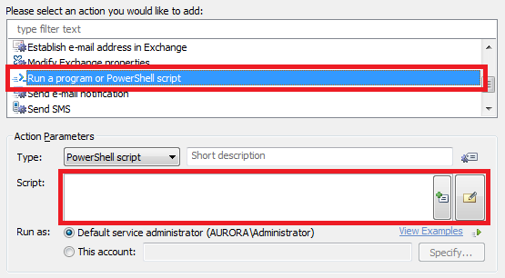

  4. Select the Run a program or PowerShell script action.
  5. In the Script field, type the following:
     Start-Sleep -s 60
    This will add a timeout of one minute to your Business Rule.

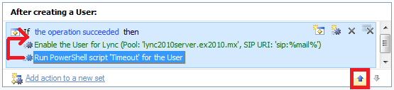

  6. Enter a short description for the script and click OK.
  7. With the help of the arrow buttons at the bottom, place the Run a program or PowerShell script action before the Enable for Lync action.
  8. Save the Business Rule.
