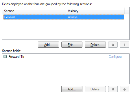

I. Create a Home Page Action that allows setting a forwarding address
For information on how to create a Home Page Action that allows modifying a user, see section Modify Object on the 5th step of the following tutorial: http://www.adaxes.com/tutorials_WebInte ... htm#modify.
On Step 4 of the section, you will find instructions on how to modify the form used for the Home Page Action. You need to configure a form that allows to update only the Forward To property.
Also, you need to add a flag to indicate that the user is being deprovisioned. For this purpose, add a predefined field for the property that you want to use and set it to True. Information on how to add predefined fields is also available on Step 4.

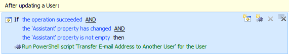

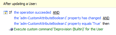

II. Create a Business Rule that performs user deprovisioning

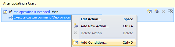

To automatically perform deprovisioning actions once the above home Page Action is executed, you need to configure a Business Rule triggered after updating a user that performs the necessary actions only when the flag is set. To create such a Business Rule:

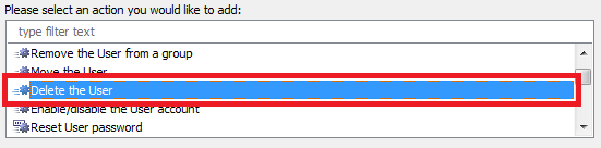

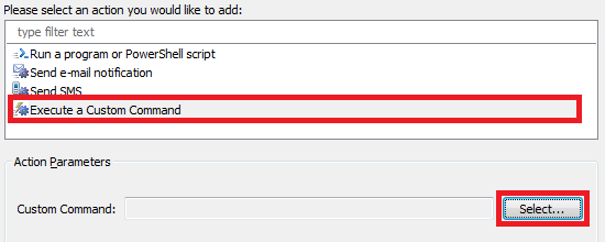

  3. On the 3rd step, you need to add an action that performs the deprovisioning actions. For this purpose, add the Execute a Custom Command action and click Select.
  4. Select the Custom Command that you use for deprovisioning and click OK 2 times.

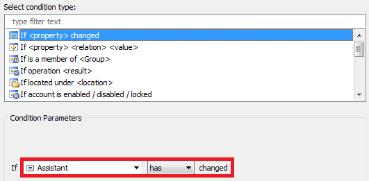

  5. Now, you need to add conditions for the Custom Command to be run only when the flag is set. Right-click the action that you've just added and click Add Condition.

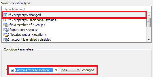

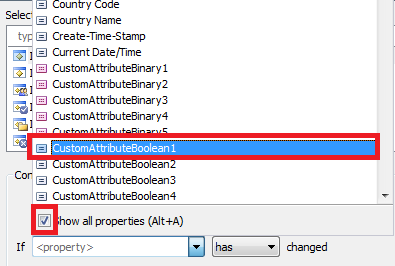

  6. Select the If <property> changed condition type.
  7. Expand the <property> drop-down list and select Show all properties.
  8. Select the virtual property that you want to use as a flag, e.g. CustomAttributeBoolean1.
  9. Select has changed.
  10. Click OK.

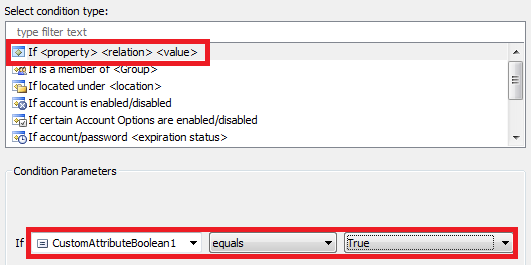

  11. Right-click the action that you've just added and click Add Condition again.
  12. Select the If <property> <relation> <value> condition type.
  13. Expand the <property> drop-down list and select Show all properties.
  14. Select the virtual property that you want to use as a flag.
  15. Select equals and True.
  16. Click OK. You should get something like this:
  17. Finish creation of the Business Rule.

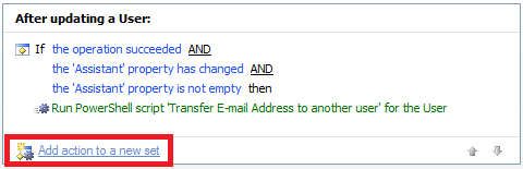

Sorry, our bad, you are correct.

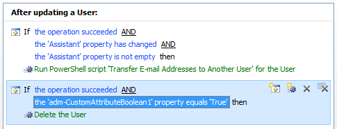

On Step I of the Automate Email forwarding when disabling/deprovisioning user, you needed to create a Home Page Action that allows you to launch the deprovisioning process and specify a person to whom the mail addresses will be transferred. You can configure the action to set a certain flag to distinguish user deprovisioning from other operations. Then, in your Business Rule, you can delete user accounts only when the flag is set.
As for the flag itself, you can use one of Adaxes custom attributes that can store boolean values, for example, CustomAttributeBoolean1. Such attributes are not stored in AD, but can be used the same as any other attributes of AD objects. When flagging a departing user, you can set the attribute to True.

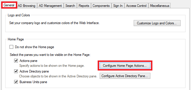

  2. In the Interface type drop-down list, select the Web Interface that you want to configure.
  3. Activate the General tab and click Configure Home Page Actions. This will bring up the Home Page Actions dialog.

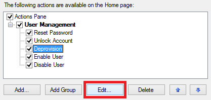

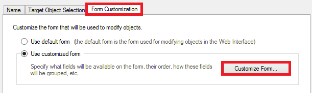

  4. Select the action that you've configured for user deprovisioning and click Edit.
  5. Activate the Form Customization tab.

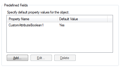

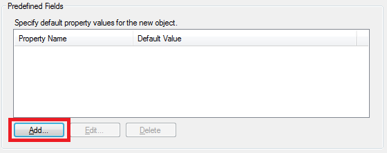

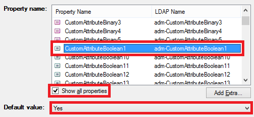

  6. In the Predefined fields section, click Add.
  7. In the Property name section, select Show all properties and select the property you want to use as a flag, e.g. CustomAttributeBoolean1.
  8. Select Yes.
  9. Click OK 4 times.

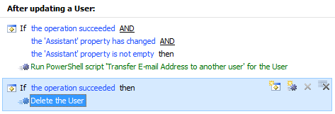

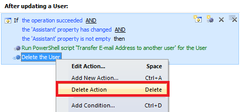

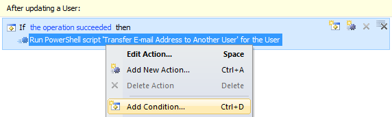

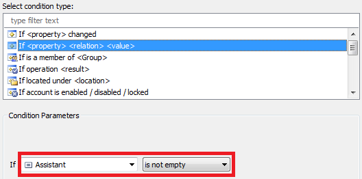

II. Configure the Business Rule to delete only flagged users
To configure your Business Rule to delete only accounts of the users flagged by the Home Page Action:

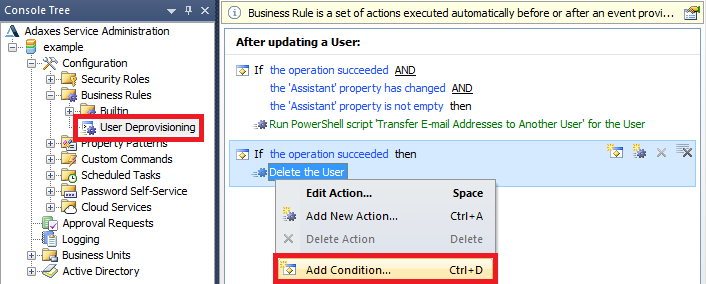

  1. On the computer where Adaxes service is located, launch Adaxes Administration Console.
  2. In the Console Tree, locate and select your Business Rule that you've configured for deprovisioning users. The actions and conditions of the rule will appear in the Result Pane (located to the right).
  3. Right-click the Delete the User action.
  4. Click Add Condition.
  5. Select If <property> <relation> <value>.
  6. Specify If CustomAttributeBoolean1 equals True.
    where CustomAttributeBoolean1 is the property that you chose for flagging departing users.
  7. Click OK. You should receive something like this:
  8. Click Save changes.

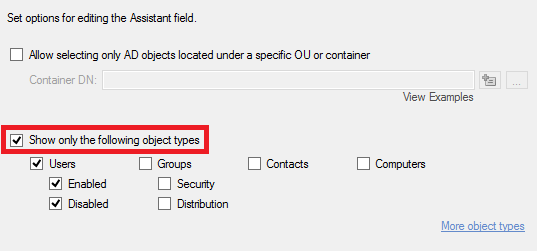

By default, you can't select distribution lists, but this is something that you can add yourself. To do this:

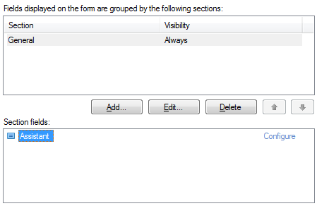

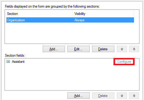

  6. Click Customize Form.

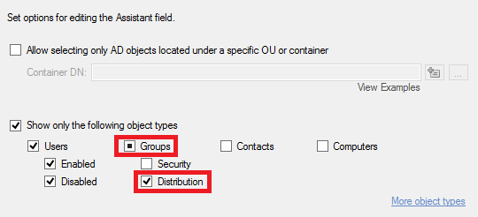

  7. Click Configure next to the field you are using to specify the user receiving the email addresses.
  8. Select Show only the following object types.
  9. Enable Groups.
  10. Make sure that only Distribution is selected.
  11. Click OK 4 times.
