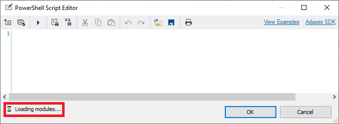

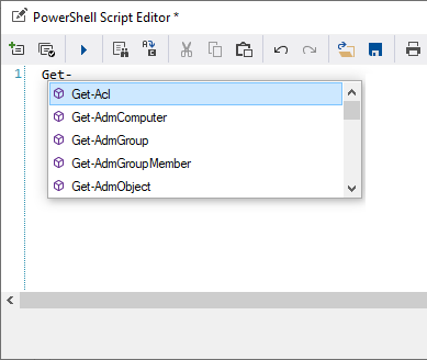

Are PowerShell commands supposed to show up in the programming interface after adding the module to the Adaxes server?
I've installed modules and they don't show.
by (810 points)
The commands are displayed in the script editor by means of autocomplete when you start typing a command. For example: image.png For the autocomplete to work, make sure that you wait for all the modules to be loaded. Information about modules still being loaded is displayed in the bottom left corner of the dialog box. image.png
