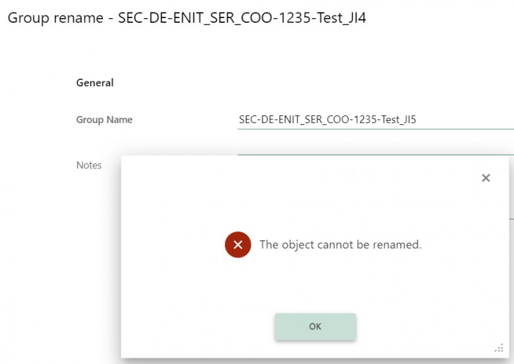

After migrating from 2017.2 to 2021.1, certain actions no longer work. If a group object is to be renamed, the message appears: The object cannot be renamed. We cannot find the reason for this. A direct renaming in the Admin Console works and the permissions in the configuration have been taken over and they look correct. Is there perhaps a useful log file?

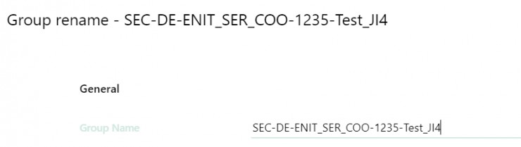

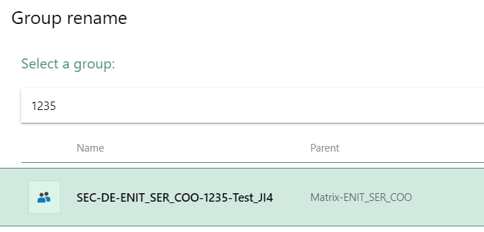

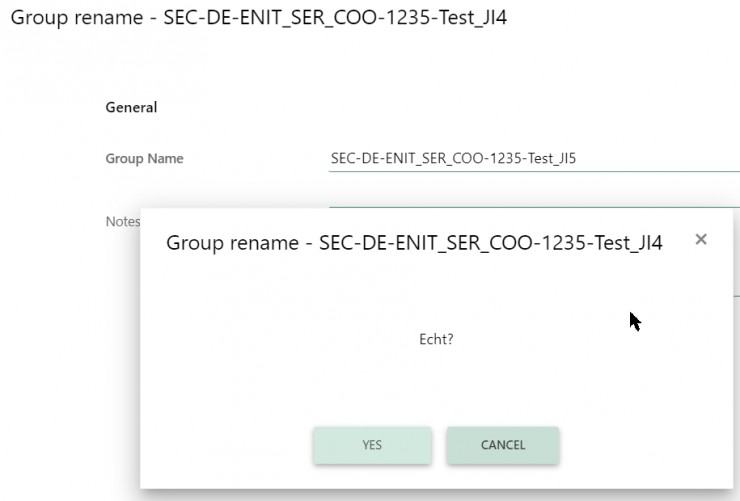

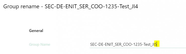

I want to rename a security group of type Global
Search
I can not find error details

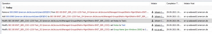

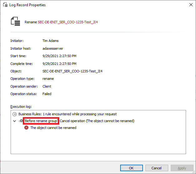

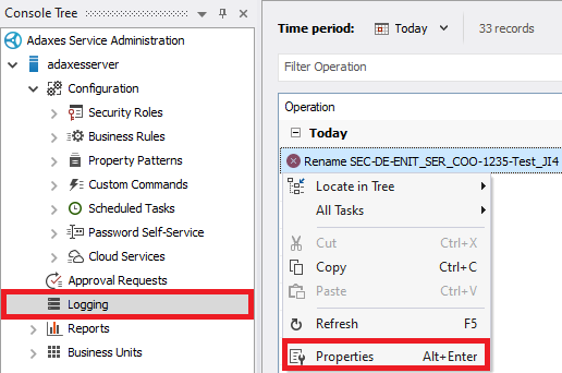

Thank you for the provided details. It looks like there is a business rule triggering before renaming a group that cancels the operation. To check the rule:
  3. Select Logging.
  4. In the Result Pane on the right, right-click the Rename SEC-DE-ENIT_SER_COO-1235-Test_JI4 operation. image.png
  5. In the context menu, click Properties.
  6. In the Execution log section you should see the business rule that cancelled the renaming. image.png
The renaming is probably not logged. Other operations were logged: image.png
Earlier, I have already disabled all business rules. But that didn't change anything.

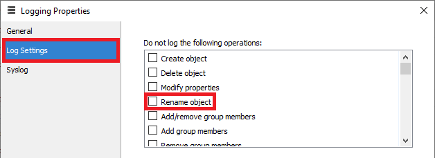

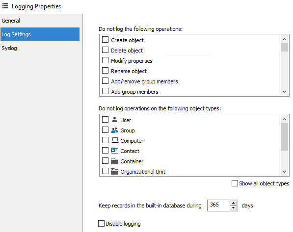

To check whether the Rename object operation is logged:
  3. Right-click Logging and then click Properties in the context menu.
  4. Activate the Log Settings tab.
  6. If the checkbox is selected, clear it, click OK, reproduce the issue and follow the instructions for checking the Execution log.
Does the issue occur only for the SEC-DE-ENITSERCOO-1235-Test_JI4 group or for any other group too?
Our Log Setting: image.png
Yes, I have already tried different groups. It always appears: The object cannot be renamed.

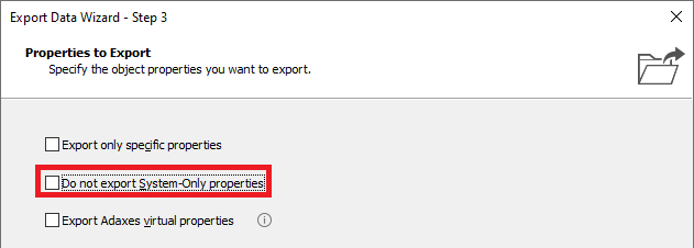

Hello Jo,
Thank you for clarifying. For further troubleshooting, please, do the following:
  3. Navigate to and right-click the group.
  4. In the context menu, navigate to All Tasks and then click Export.
  5. In the dialog box that opens, select LDIF and click Next twice.
  6. On the Properties to Export step, clear the Do not export System-Only properties checkbox. image.png
  7. Click Export.
  8. Send the export file to us (support@adaxes.com).

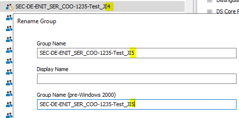

Thank you for the provided export file. The group looks fine and according to the property values there should be no issues renaming it. Could you, please, try renaming the group in Adaxes Administration console and Active Directory Users and Computers? Does it work fine?
That works perfectly
