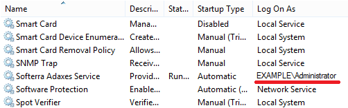

Check the user account used to run Softerra Adaxes Service. The service must be run using the account of Adaxes default service administrator (the user you specified when installing Adaxes Service on the computer). Only that account has sufficient permissions to perform the necessary operations on the AD LDS instance that serves as Adaxes backend. To check which account is used:
  1. Launch the Services applet: press Win+R, type services.msc and then press Enter.
  2. Check which user account is displayed for Softerra Adaxes Service in the Log On As column.
Thank you. This helped me solve the problem. The account name was the same, but someone had deleted and recreated the service account for some reason. I restored the original service account and was able to connect.
