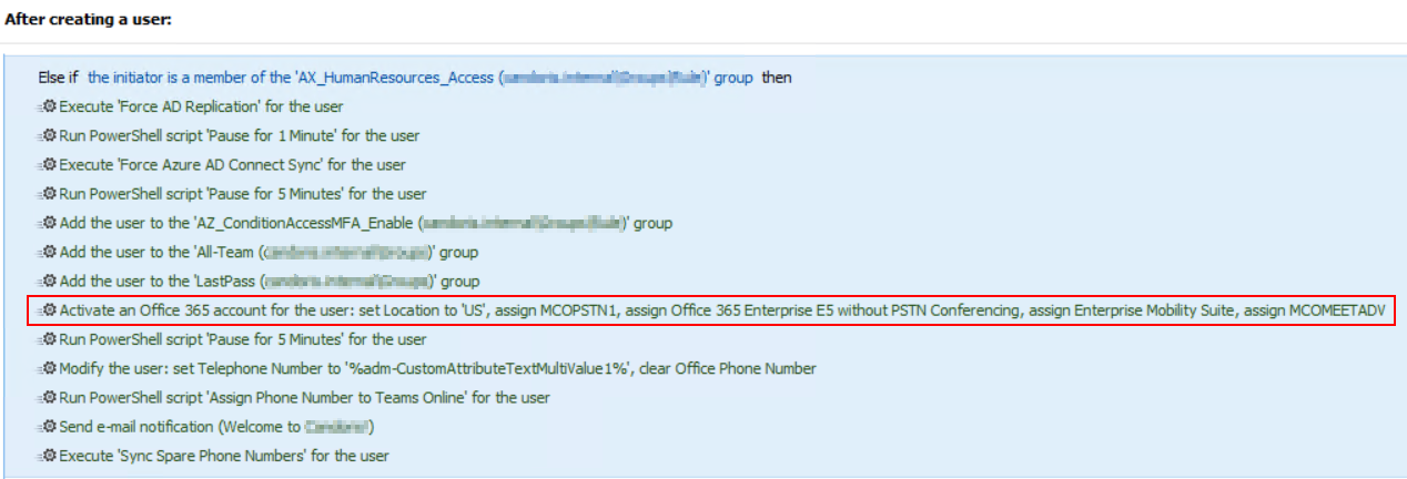

I'm looking for a way to receive a notification/approval request when a new user is created and the business rule attempts to assign O365 licensing, however there are no available licenses. Typically we purchase these licenses as needed so we're not paying monthly for something that we aren't using. I understand there is no PowerShell way to script the purchase of a license and I don't want to cancel the new user operation due to the missing license. Is it possible to detect this and send the job for approval. I have a screenshot of our business rule below. Basically what I want to happen is pause at the activate O365 license step and wait for a license to be purchased, before continuing as the other remaining steps like assigning a Microsoft Teams phone number will be dependent on the license being assigned.

Hi Support,

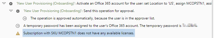

I've been giving this some thought as to how I want to handle. In the log output as shown below it tells me there is no available license. Is it possible to catch that error and trigger an email to someone telling them a license needs purchased? Being able to add additional information to the email like the license name, and the user that needs the licensed assigned would be great.
Also, I have 4 different licenses added to a new user. It attempts the MCOPSTN1 license first and finds no available licenses but doesn't attempt the others, even though they do in fact have available licenses. Any way to allow the job to continue trying the additional licenses?

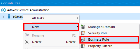

Thank you for the clarification. The script should be used in a Business Rule triggering Before modifying Office 365 properties of a user. To create the rule:
  2. In the Console Tree, right-click your Adaxes service node.

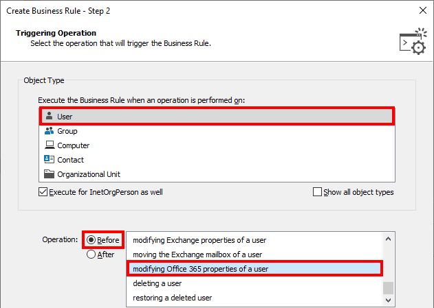

  4. On step 2 of the Create Business Rule wizard, select the User object type.
  5. Select Before modifying Office 365 properties of a user and click Next.

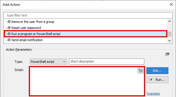

  6. Click Add an action.
  8. Paste the below script into the Script field. In the script:

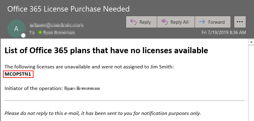

This is awesome, it works perfectly!! Thanks so much!! Really appreciate your time to help me with this.
One minor little tweak that I hope would be easy. Is it possible to output the display name of the license instead of the SKU in the email? The people getting this email will be utilizing the O365 admin center to purchase additional licenses and wouldn't know the SKU correlation.

Hello Ryan,
That is exactly what the script does. It includes the default display names of unavailable licenses into the report. MCOPSTN1 is a display name of a license, not an SKU Part Number. As a solution, you can specify custom user-friendly display names for all Office 365 licenses in the settings of your tenant and update the script to use the display names. For information on how edit the license display names, have a look at the following help article (point 8): https://www.adaxes.com/help/?HowDoI.Per ... Plans.html.
